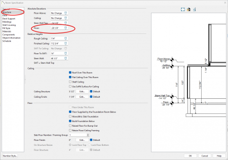

WoodChuck267 Posted Tuesday at 03:46 AM Share Posted Tuesday at 03:46 AM Garage floor elevation is at 0". I would like to lower the garage slab floor to -16" any suggestions. Already have structure built on Chief. Link to comment Share on other sites More sharing options...
kMoquin Posted Tuesday at 01:12 PM Share Posted Tuesday at 01:12 PM You can change this on the structure tab of the room specification doalog 1 Link to comment Share on other sites More sharing options...

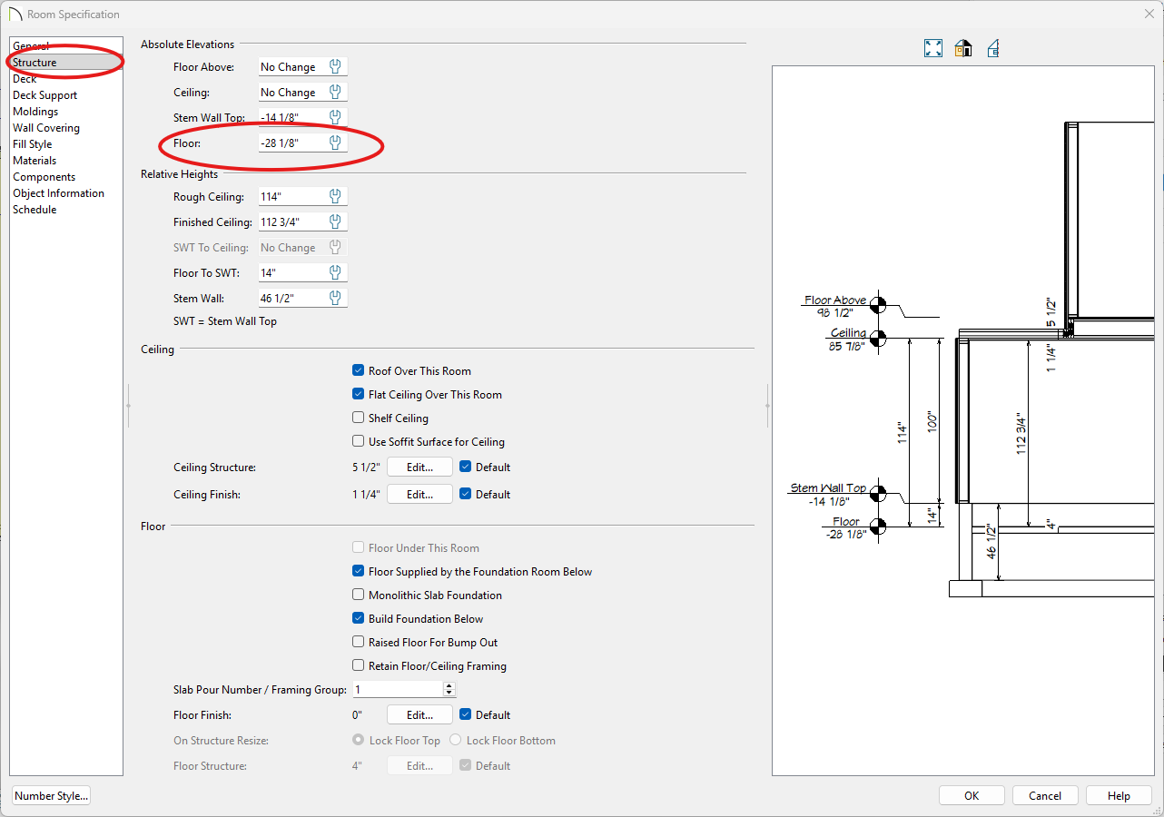

WoodChuck267 Posted Tuesday at 03:03 PM Author Share Posted Tuesday at 03:03 PM (edited) I have x17/x18 version of Chief. That doesn't lower the exterior walls of the garage. My walls for the garage start framing at top of subfloor for main house. I want the garage walls to start framing 4" below top of house stem wall. Which is about 12 5/8" down. How do I achieve that? Thanks Edited Tuesday at 03:05 PM by WoodChuck267 Link to comment Share on other sites More sharing options...
javatom Posted Tuesday at 05:36 PM Share Posted Tuesday at 05:36 PM In the room specification dbx there is a way to do what you want. Go to the item marked FLOOR TO SWT. That number determines where the concrete stem wall stops and the wood framed wall begins. Link to comment Share on other sites More sharing options...
