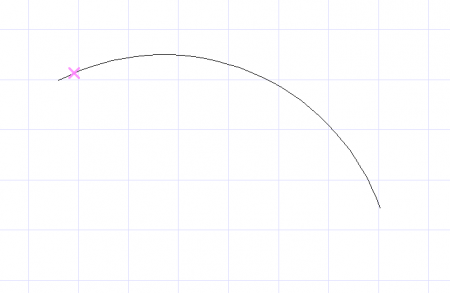

Gawdzira Posted August 13 Share Posted August 13 (edited) Not that kind of point loading. When I draw a curved line and then click on the line just after finishing the command I am getting a temp point. Why? Edited August 13 by Gawdzira added image Link to comment Share on other sites More sharing options...
VHampton Posted August 14 Share Posted August 14 You wanted a curved line, but Chief decided you needed a treasure map instead. Try this... CAD > Points > Delete Temporary Points. Link to comment Share on other sites More sharing options...
