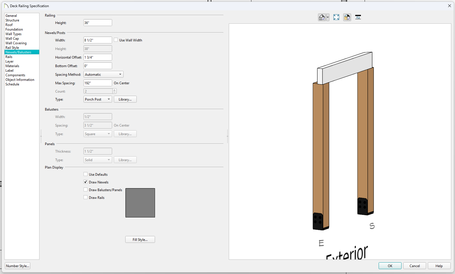

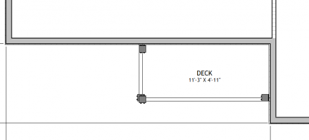

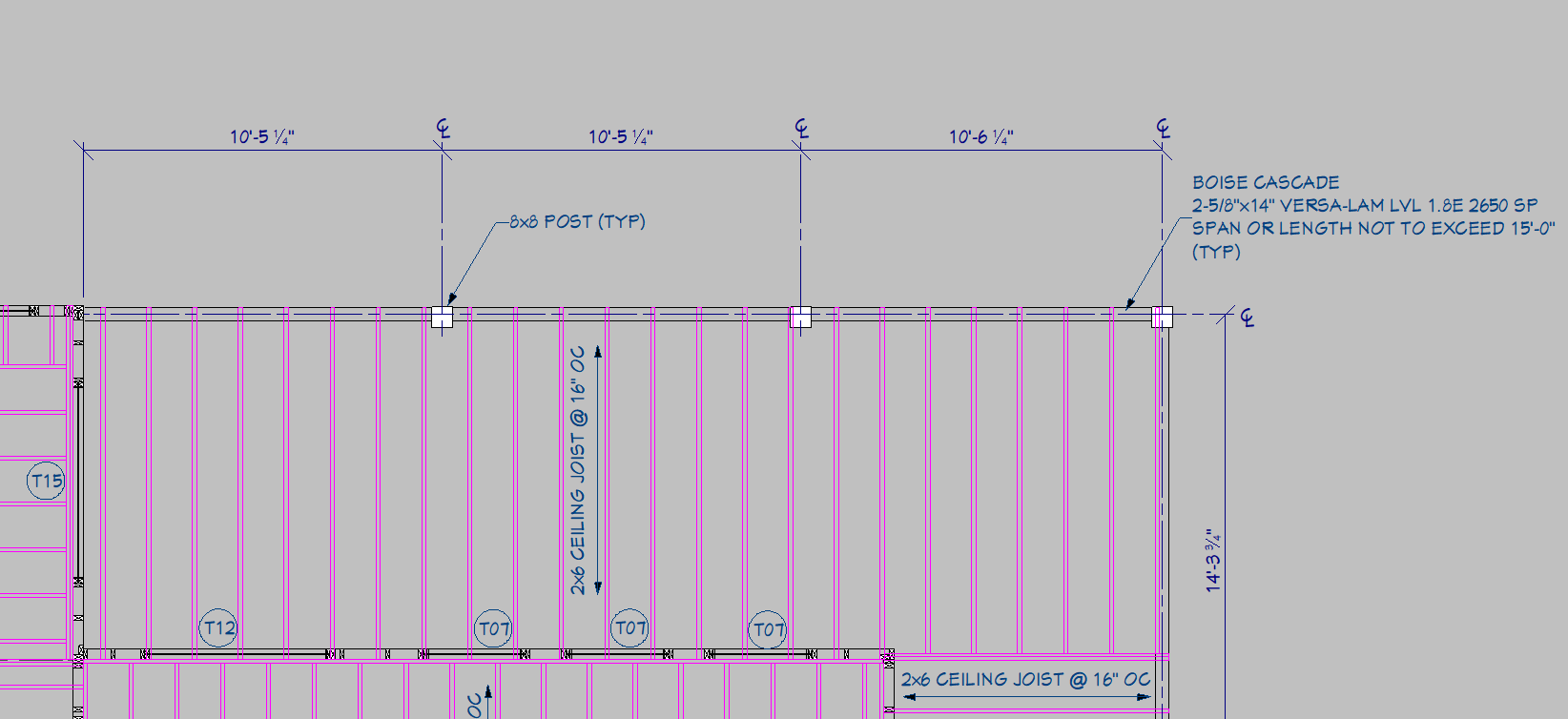

Jonathan3891 Posted Wednesday at 11:59 PM Share Posted Wednesday at 11:59 PM For the life of me, I cannot figure out how we made the beam in the railing wall shown in the first image display as a double line in plan view. I have compared the wall, railing, beam, and layer settings between the two examples, and everything appears to be configured the same. However, in the second plan, the beam only displays as a single line. Does anyone know which setting controls this appearance, or what I may be overlooking? Any help would be greatly appreciated. Thanks! Link to comment Share on other sites More sharing options...

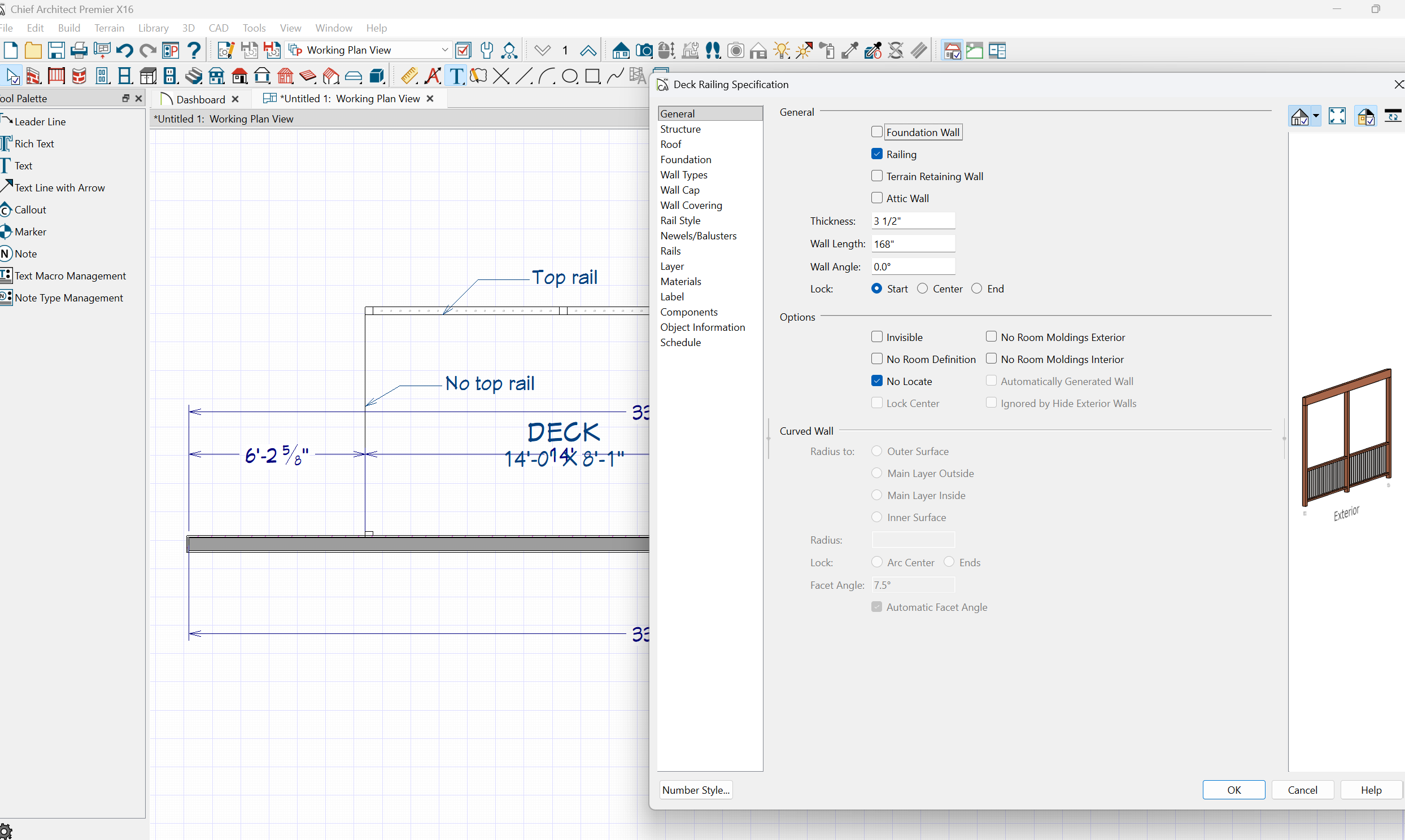

Garybills Posted Thursday at 01:29 AM Share Posted Thursday at 01:29 AM I can get the double line to show if the rail style includes top rail. If top and bottom rails are not included, then I only get a single line. That may be the difference. Link to comment Share on other sites More sharing options...
JonathanK Posted Thursday at 03:34 PM Share Posted Thursday at 03:34 PM Could it be in the Deck Railing Specification > Newels/Balusters Tab you have "Draw Rails" checked? If you uncheck it, it shows a double line. Link to comment Share on other sites More sharing options...
