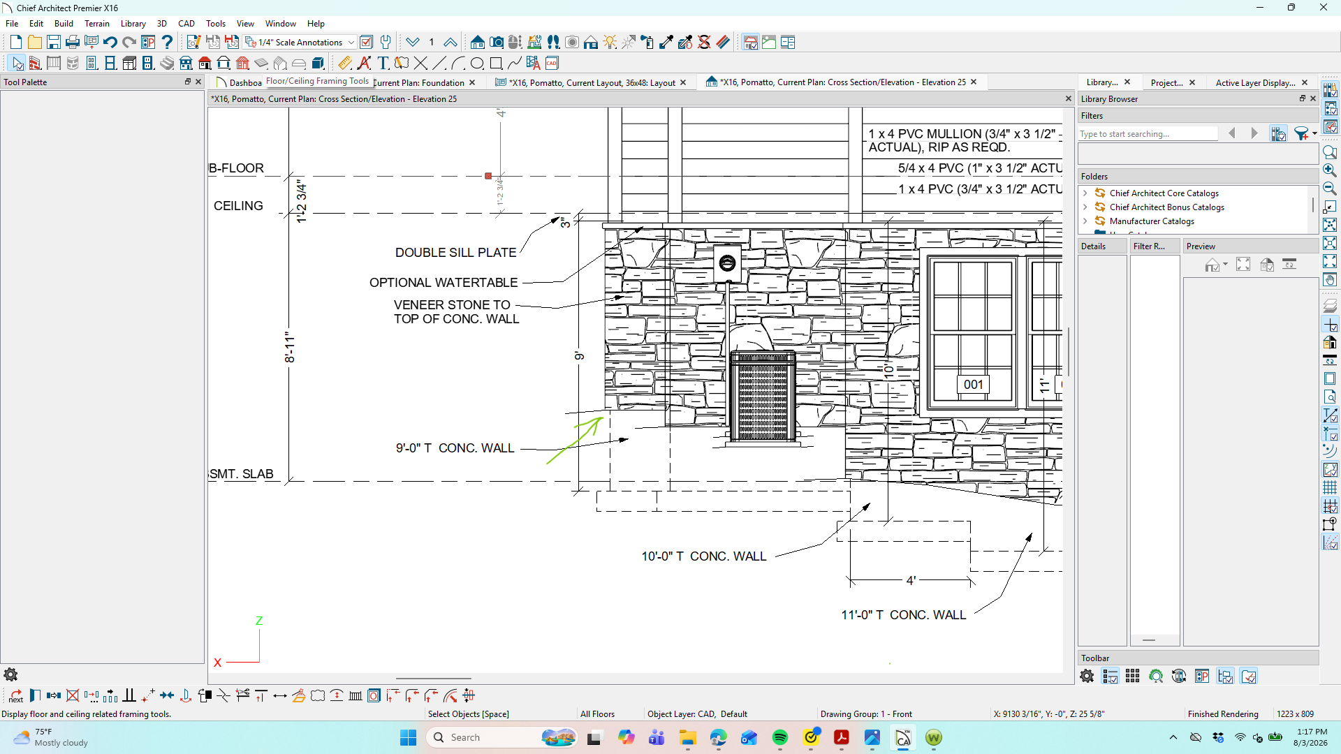

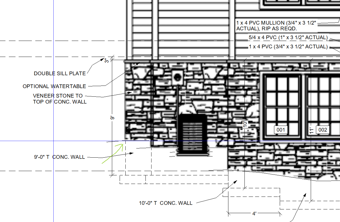

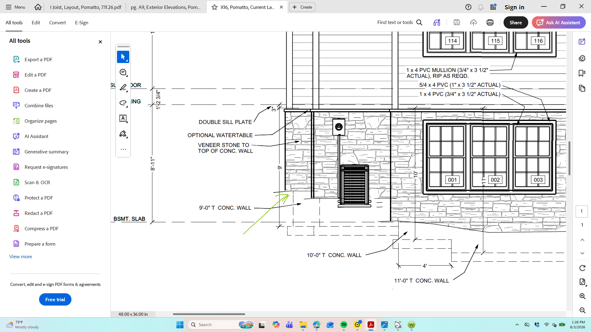

JHallHomes Posted August 3 Author Share Posted August 3 The plan below was done in x16 but I'm experiencing the same problem in x17 on other projects. In the pictures below look at the dotted lines that represent the foundation wall below grade. In all cases this dotted line should be offset 2" from the face of the veneer stone. Looks great in the elevation before I sent it to layout but shifts around looking at it in layout view and Chief pdf's of the layout view. I also attached a pdf copy of the entire plan page. The dotted foundation wall lines jump around depending on which building corner you're looking at. pg. A9, Exterior Elevations, Pomatto, 6.3.26.pdf Link to comment Share on other sites More sharing options...

JHallHomes Posted August 4 Author Share Posted August 4 No, the dashed lines are not walls at all. They are just cad lines I've drawn on top of the elevation. All cad lines and text items that I add to the elevation move around when I send it to layout and again when I print to pdf. You can see it in the window tags too. The widow tags are just text boxes. Look at window "001" in the 3 attachments. The 1st attached image is the Chief pdf of the layout page, and the window tag is shifted to the right. The second image is of the layout page and the window tag is shifted to the left. The 3rd image is the elevation before it is sent to a layout and the tag is centered in the window as I drew it. Link to comment Share on other sites More sharing options...
