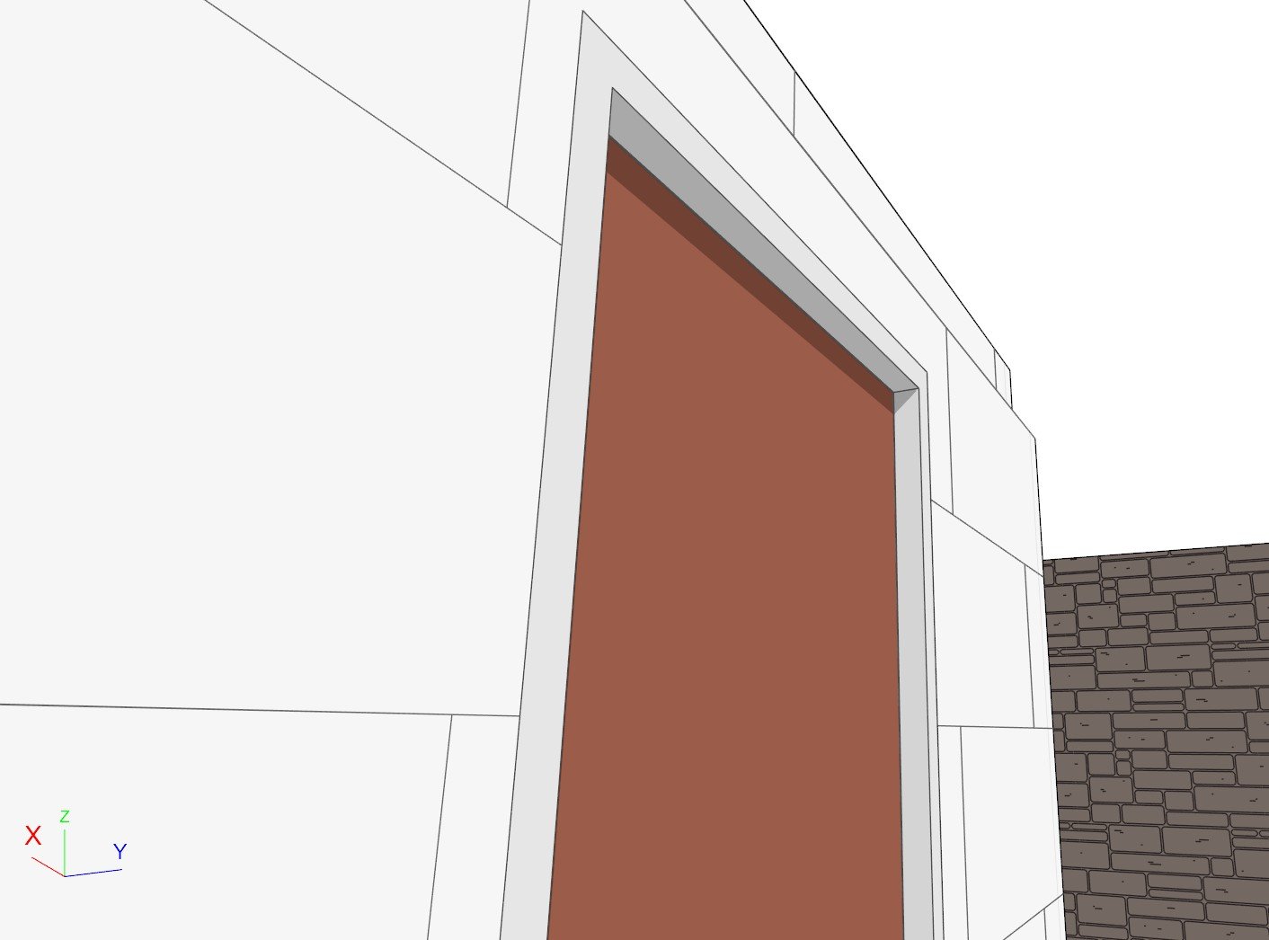

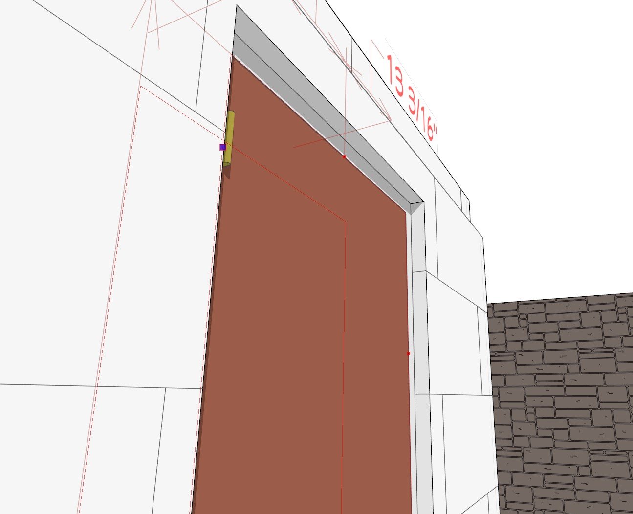

Larry_Sweeney Posted July 31 Share Posted July 31 I have a ICF basement pony wall. The lower section is 11" !CF blocks and the upper section is one row of 9" !CF blocks. I'm installing a door in the wall of the lower section and I want the hinge side of the door flush with the inside of the 11" ICF blocks. When I install the door the jamb lines up with the 9" ICF block above. (attachment 1) I unchecked "Fit jamb to Wall" in the Interior Door Specification dbx. and extended the jamb to the inside face of the 11" ICF block, but the door still remains lined up with the 9" ICF block above. (attachment 2) Is there some type of work around to get the door to the inside face of the wall or am I just missing something in the dbx. As always, I appreciate that you take your time for my problem. Link to comment Share on other sites More sharing options...
Solution DBCooper Posted July 31 Solution Share Posted July 31 Have you tried moving the panel around using the "panel offset"? 1 Link to comment Share on other sites More sharing options...
Larry_Sweeney Posted August 1 Author Share Posted August 1 DBCooper..............................Thank you, that moved the door to where I wanted it. Why isn't it called "door offset". I guess I think "old school". Panel, to me, is part of a door, not "the door". There are times that make me wonder how they come up with these reference names. I suppose it's been in the specifications dbx. for some time, but this is the first instance for me. I thank you for sharing your wisdom and time with me-------------much appreciated! Have a great day. Link to comment Share on other sites More sharing options...
