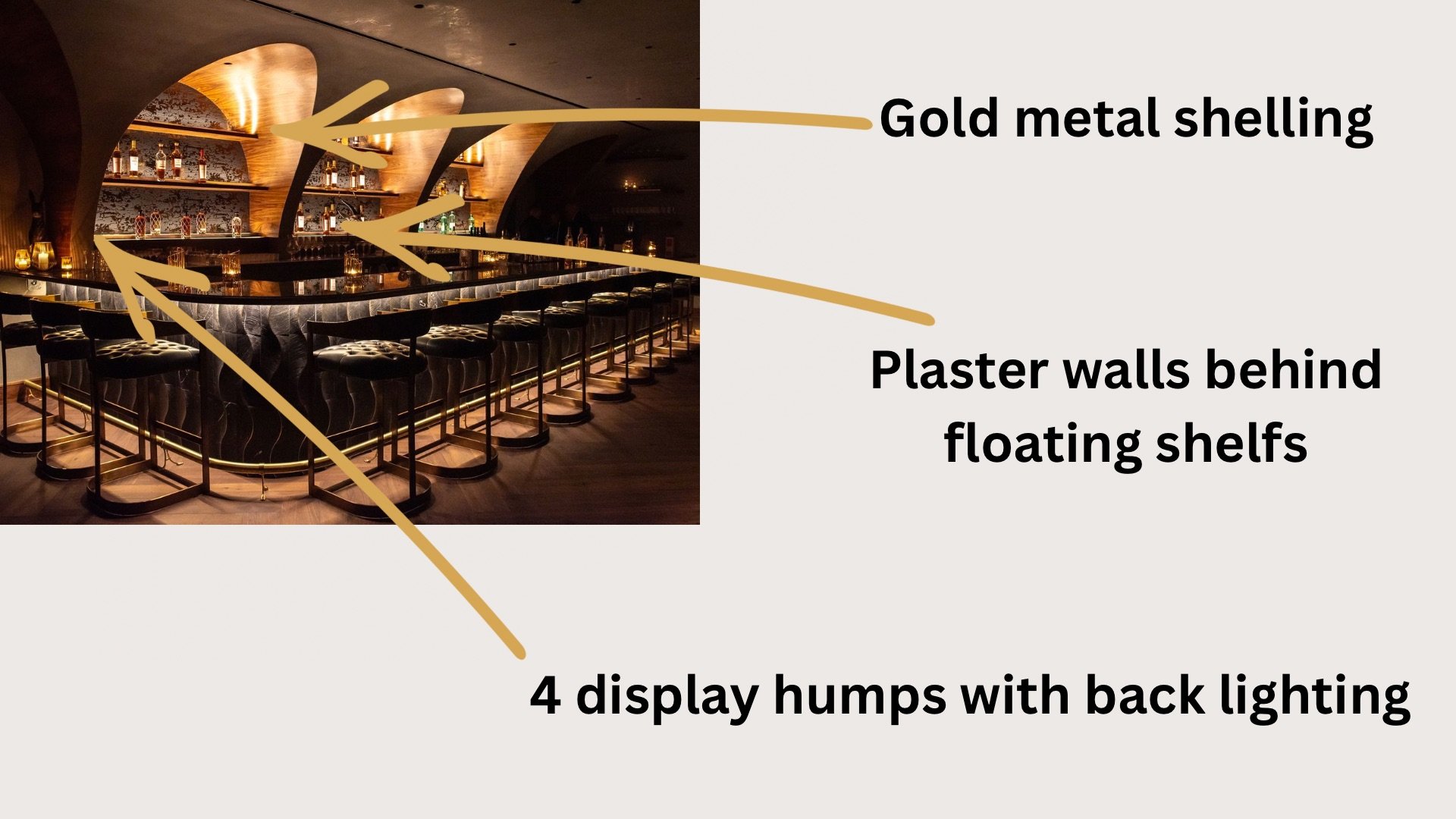

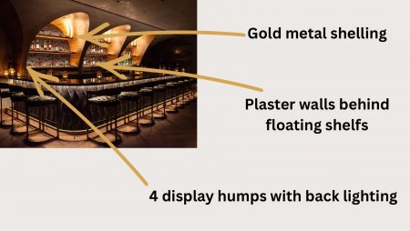

ALICIAJUSTINE Posted July 23 Share Posted July 23 I have a commercial client wanting curved alcoves for the bar shelving. I know how to make standard alcoves but this is stumping me. I have attached the client board for visual. Link to comment Share on other sites More sharing options...
Solution GeneDavis Posted July 23 Solution Share Posted July 23 You can readily model that in Chief 3D solids using booleans. And that is what you'll get, solids. How it gets built is up to the contractor. Link to comment Share on other sites More sharing options...
PitMan71 Posted July 24 Share Posted July 24 22 hours ago, GeneDavis said: You can readily model that in Chief 3D solids I agree with this. I would model it in an elevation view as its easier to get it oriented correctly. Link to comment Share on other sites More sharing options...
ALICIAJUSTINE Posted Monday at 02:52 AM Author Share Posted Monday at 02:52 AM On 7/23/2026 at 1:36 PM, GeneDavis said: You can readily model that in Chief 3D solids using booleans. And that is what you'll get, solids. How it gets built is up to the contractor. Yes this worked! I think I was having brain fart! Link to comment Share on other sites More sharing options...
ComputerMaster86 Posted yesterday at 04:18 AM Share Posted yesterday at 04:18 AM It's a little tricky but chief as the ability of rounded ceiling planes. Link to comment Share on other sites More sharing options...
