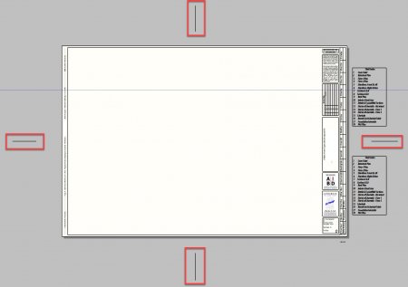

SC_drafting Posted July 13 Share Posted July 13 Super simple, quick fix for a minor but annoying issue- it can be hard for the center object tool to pick up the midpoint of a border on a layout sheet when you're trying to center something. I went to page 0 and added 2 white lines (vertical and horizontal) on the very back drawing group, splitting the box. Now there's a whole line for the tool to pick up on and it's much less finicky. Hope that helps someone out there a bit! 1 Link to comment Share on other sites More sharing options...

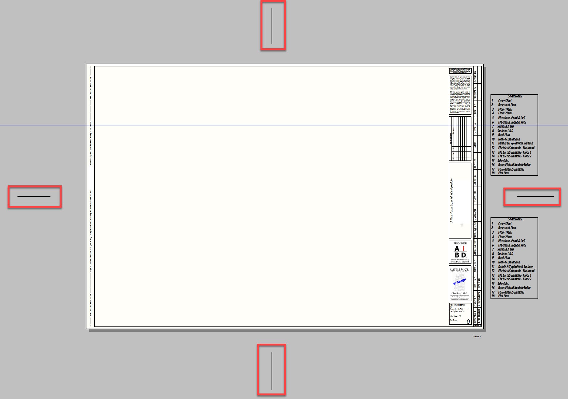

Renerabbitt Posted July 14 Share Posted July 14 I do something simlar: Link to comment Share on other sites More sharing options...

CharlesVolz Posted August 15 Share Posted August 15 (edited) I add crosshairs that are centered on my drawing area on Sheet 0 so they can be used for all the sheets. I add more as needed. Edited August 15 by CharlesVolz 1 1 Link to comment Share on other sites More sharing options...
