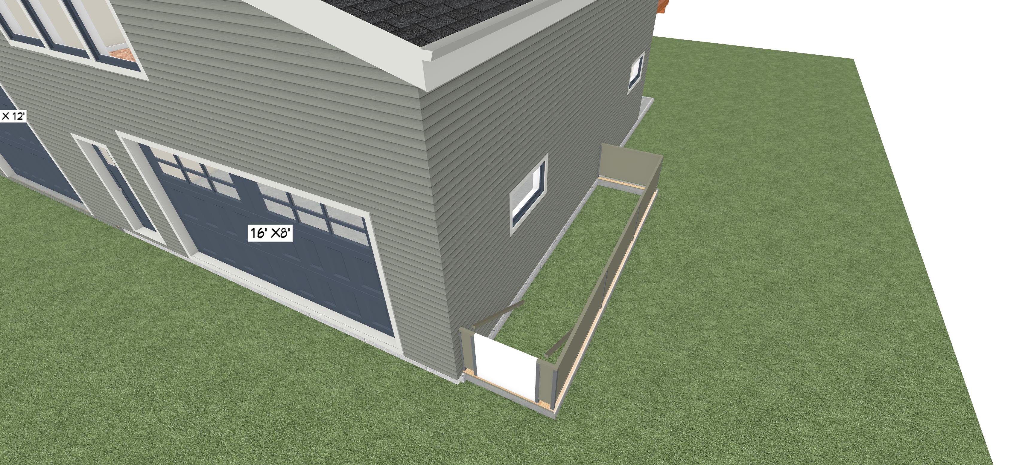

Artisan_TH Posted July 2 Share Posted July 2 How do I remove terrain from the stairwell opening? Thanks Link to comment Share on other sites More sharing options...

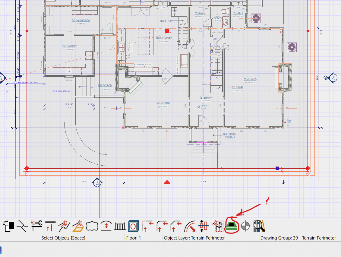

JKEdmo Posted July 2 Share Posted July 2 You can create a terrain perimeter hole that you can manually edit to follow the stairwell. Select your terrain perimeter object and then click this option: 2 1 Link to comment Share on other sites More sharing options...

CharlesVolz Posted July 2 Share Posted July 2 (edited) You can also make that exterior stairwell a room and check Hide Terrain Intersected by Building. i. The program will place an automatic terrain hole in your terrain using the walls on the same floor that your terrain perimeter is on. ii. Generally, you want to place the terrain on Floor 0 so that cantilevered building areas like boxed windows do not cut a hole in the terrain. Only your foundation walls influence the terrain cut out. Edited July 2 by CharlesVolz Link to comment Share on other sites More sharing options...
