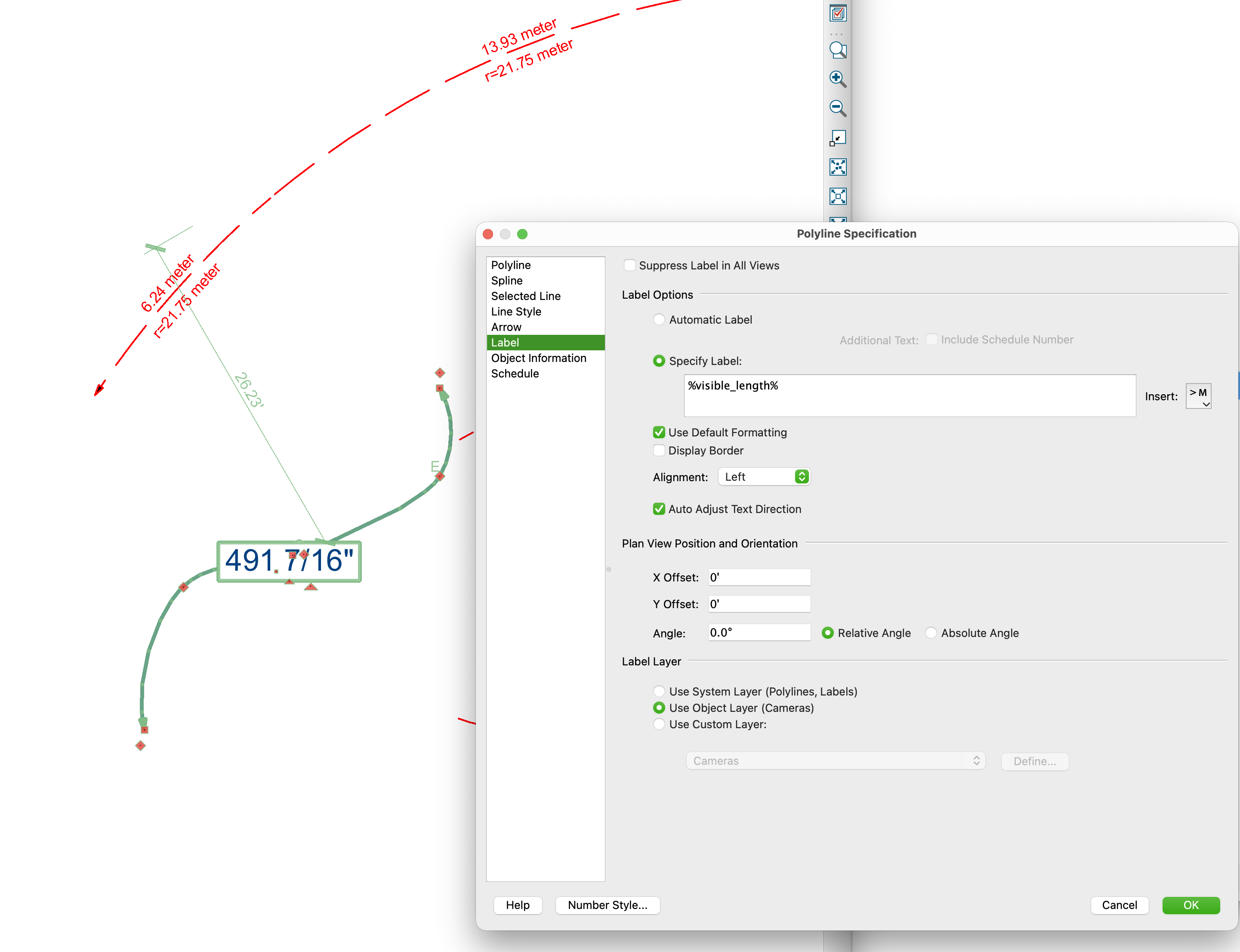

dshall Posted June 6 Share Posted June 6 How do I change the line length from inches to feet? The spline length is a macro label Link to comment Share on other sites More sharing options...
DBCooper Posted June 6 Share Posted June 6 Try using %visible_length.to_ft.round(2)%. 1 Link to comment Share on other sites More sharing options...
dshall Posted June 7 Author Share Posted June 7 Thanks DB, much appreciated! Link to comment Share on other sites More sharing options...
