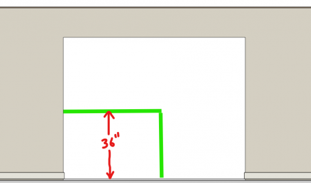

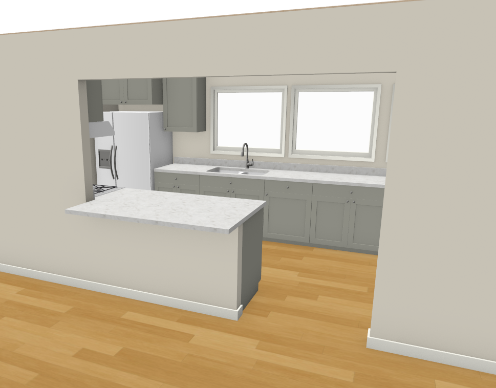

builtright3 Posted yesterday at 04:39 AM Share Posted yesterday at 04:39 AM I would like to put a half wall in this opening. Anyone know how to achive this without having to do a pass through window and a doorway? Link to comment Share on other sites More sharing options...

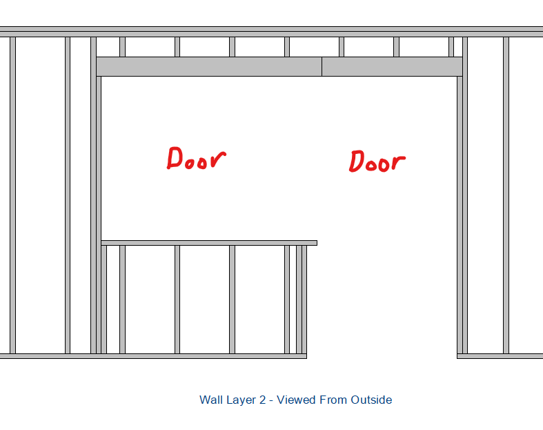

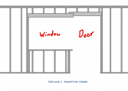

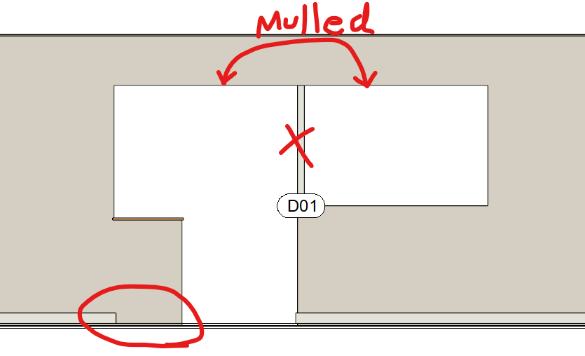

PitMan71 Posted yesterday at 01:40 PM Share Posted yesterday at 01:40 PM Use two doorways beside one another set the opening/half wall the height and distance off the floor that you need and use the mull tool to mull them. Link to comment Share on other sites More sharing options...
Joe_Carrick Posted yesterday at 02:01 PM Share Posted yesterday at 02:01 PM create the half wall "out of plane", no room definition and then move it into placein the opening. Link to comment Share on other sites More sharing options...

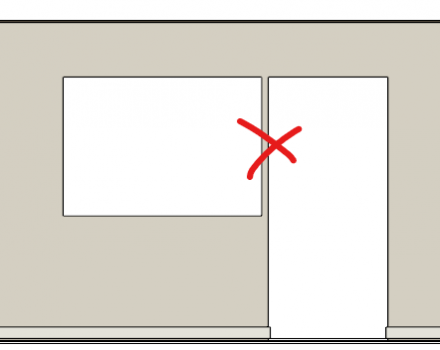

builtright3 Posted yesterday at 02:44 PM Author Share Posted yesterday at 02:44 PM (edited) 1 hour ago, PitMan71 said: Use two doorways beside one another set the opening/half wall the height and distance off the floor that you need and use the mull tool to mull them. 43 minutes ago, Joe_Carrick said: create the half wall "out of plane", no room definition and then move it into placein the opening. I tried both ideas, thank you! The half wall doesnt include the base mouling so I'm guessing I just have to put that in manually The mulled unit leaves a post between the two unless Im doing something wrong Edited yesterday at 02:45 PM by builtright3 Link to comment Share on other sites More sharing options...

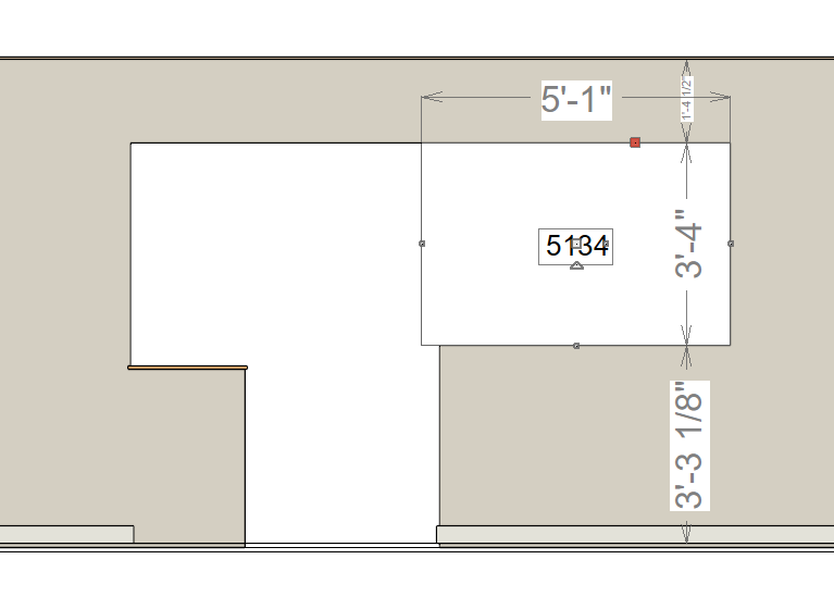

builtright3 Posted yesterday at 02:57 PM Author Share Posted yesterday at 02:57 PM This is interesting. I didn't mull the openings together on this one. I simply overlapped the window opening over the door opening using the Ctrl key, and it came out perfect! 1 Link to comment Share on other sites More sharing options...
builtright3 Posted yesterday at 03:24 PM Author Share Posted yesterday at 03:24 PM The header height works better if Im using to doors rather than a window and a door Link to comment Share on other sites More sharing options...

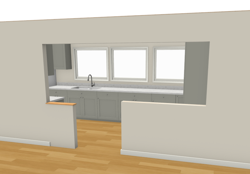

builtright3 Posted 23 hours ago Author Share Posted 23 hours ago 1 hour ago, Joe_Carrick said: create the half wall "out of plane", no room definition and then move it into placein the opening. 1 hour ago, Joe_Carrick said: create the half wall "out of plane", no room definition and then move it into placein the opening. Thank you guy's foor your help. Finish came out great! Link to comment Share on other sites More sharing options...
PitMan71 Posted 19 hours ago Share Posted 19 hours ago 4 hours ago, builtright3 said: Thank you guy's foor your help. Finish came out great! looks great! Well done. Link to comment Share on other sites More sharing options...
