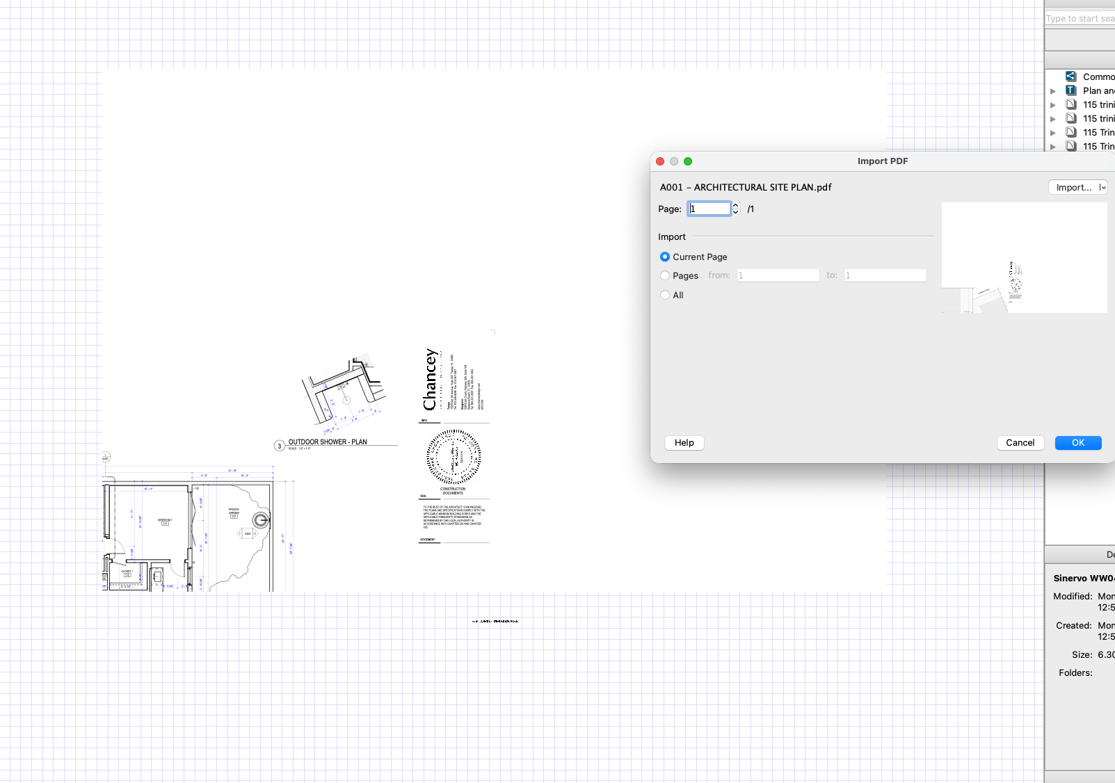

TheMegster Posted June 1 Share Posted June 1 Hey everyone! I need some help with importing a PDF of a floor plan into Chief. When I try to import, it defaults to a view where like 85% of the pdf is cut off. Plesae see the image below to see what I mean. I try adjusting the box around the PDF, but when I try to adjust the crop it doesn't change the view I'm getting of the plan. Thanks! Link to comment Share on other sites More sharing options...

Greg_NY61 Posted June 2 Share Posted June 2 Check your scale or paper size when importing or you drawing with X,Y being way off on the drawing. I always had X,Y set to 0 and never had that problem. 1 Link to comment Share on other sites More sharing options...
