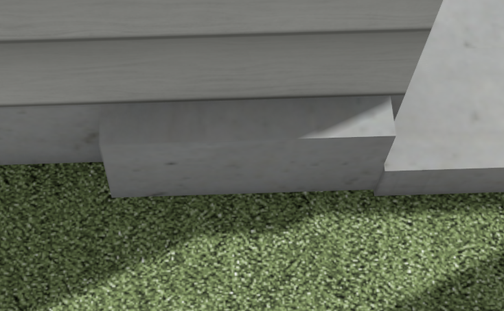

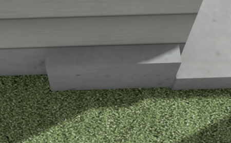

AllGen Posted Thursday at 04:51 PM Share Posted Thursday at 04:51 PM Hello, first post here. Brand new to CA. Using premier x17. I've designed a small house, and I have everything the way the engineer has specified and all call outs and notes. The only thing (that I can see anyway) that is wrong is this bump out on the porch/exterior wall junction. The engineer has specified to the porch be 2-3" wider than the porch posts that support the beams. This is so a wet set bolt be installed on the corner and a simpson ABU66 can be used. I achieved that by offsetting the footing on the open railing walls. Now I am left with this that I am trying to get rid of. If I go to the foundation layer and move it, the entire footing moves with it and it goes flush with the post again. Thanks Link to comment Share on other sites More sharing options...
Renerabbitt Posted Thursday at 05:36 PM Share Posted Thursday at 05:36 PM 44 minutes ago, AllGen said: Now I am left with this that I am trying to get rid of. If I go to the foundation layer and move it, the entire footing moves with it and it goes flush with the post again. please post your plan so we can illustrate a fix. You can use a free service like wetransfer or if you have cloud storage to share the plan file 2 1 Link to comment Share on other sites More sharing options...
AllGen Posted Thursday at 11:39 PM Author Share Posted Thursday at 11:39 PM Thank you, I figured it out. Although not sure it was the "right" way. Its gone and everything looks ok Link to comment Share on other sites More sharing options...
