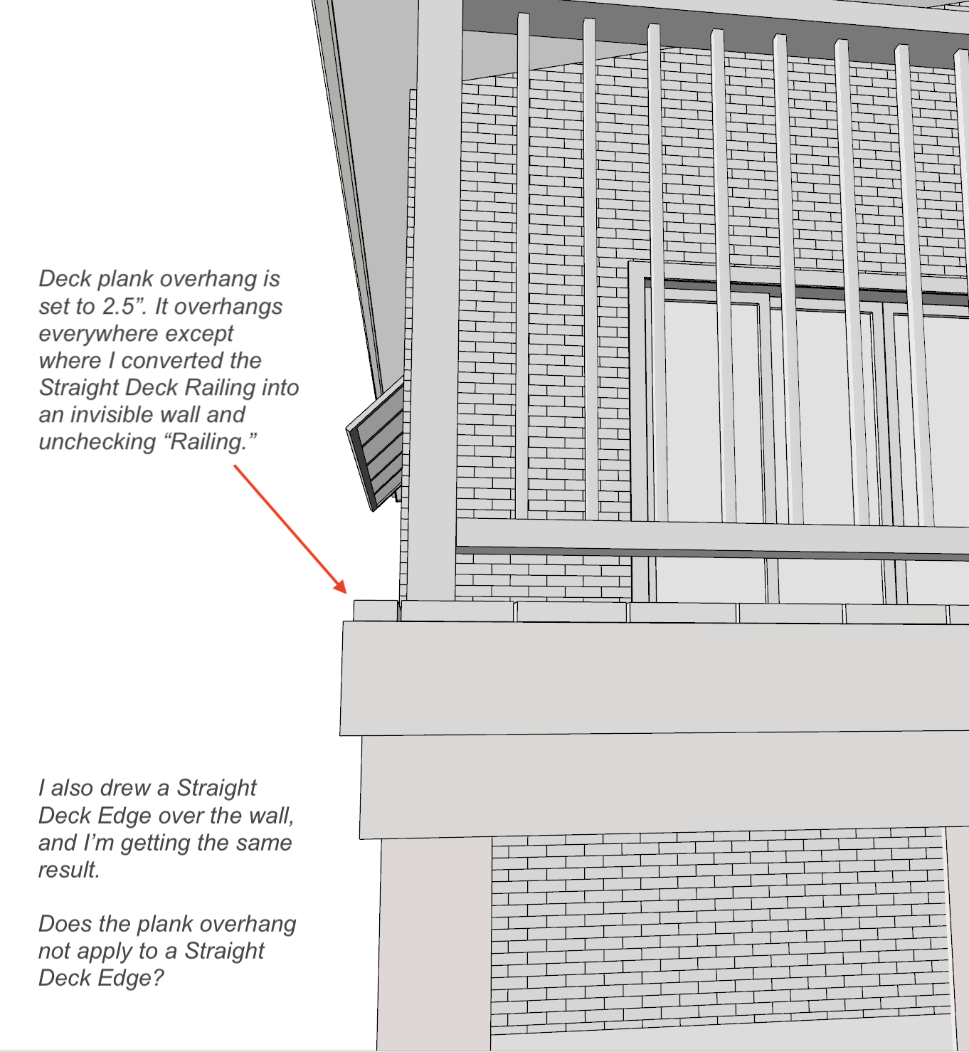

DefinedDesign Posted May 23 Share Posted May 23 I’m running into an issue with deck plank overhang in X17 and wanted to see if anyone has encountered this before. My deck plank overhang is set to 2.5”. The overhang generates correctly around the deck except at one location where I converted a Straight Deck Railing into an invisible wall and unchecked “Railing.” I also tried drawing a Straight Deck Edge over the wall and get the same result. At that location, the first deck plank stops flush instead of maintaining the 2.5” overhang. Is this not possible? Link to comment Share on other sites More sharing options...

DefinedDesign Posted Monday at 02:35 PM Author Share Posted Monday at 02:35 PM 22 hours ago, DBCooper said: Why did you make an invisible wall that is not a railing? Mostly because I was trying to avoid reintroducing a wall issue I previously worked through with Chief Training. During that session, I was instructed to use a railing wall in that location as part of the workaround to eliminate a hole that was appearing where the deck and wall intersected. Since the workaround resolved the issue, I was hesitant to remove that wall entirely and risk recreating the problem. My thought process was that converting it to an invisible wall and unchecking “Railing” might preserve the corrected wall behavior while functioning similarly to a Straight Deck Edge. Clearly that assumption may have been incorrect. At this point I will probably submit the plan to Chief so I can determine whether this is expected behavior, user error, or a software limitation/workaround interaction. Link to comment Share on other sites More sharing options...
