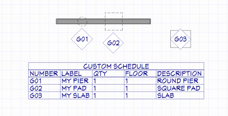

DBCooper Posted May 20 Share Posted May 20 If you are using X17, piers, pads, and slabs can all have custom labels and can be added to custom schedules. I can't remember about X12, but I don't think it could do this. Link to comment Share on other sites More sharing options...

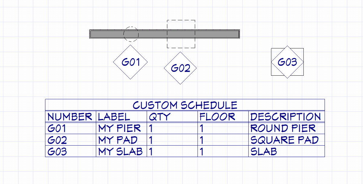

Alaskan_Son Posted May 20 Share Posted May 20 In X12, your best bet is probably to just place Notes referencing each different pier and pad. Then you can simply use a custom Note Schedule as a Pier Schedule Link to comment Share on other sites More sharing options...
