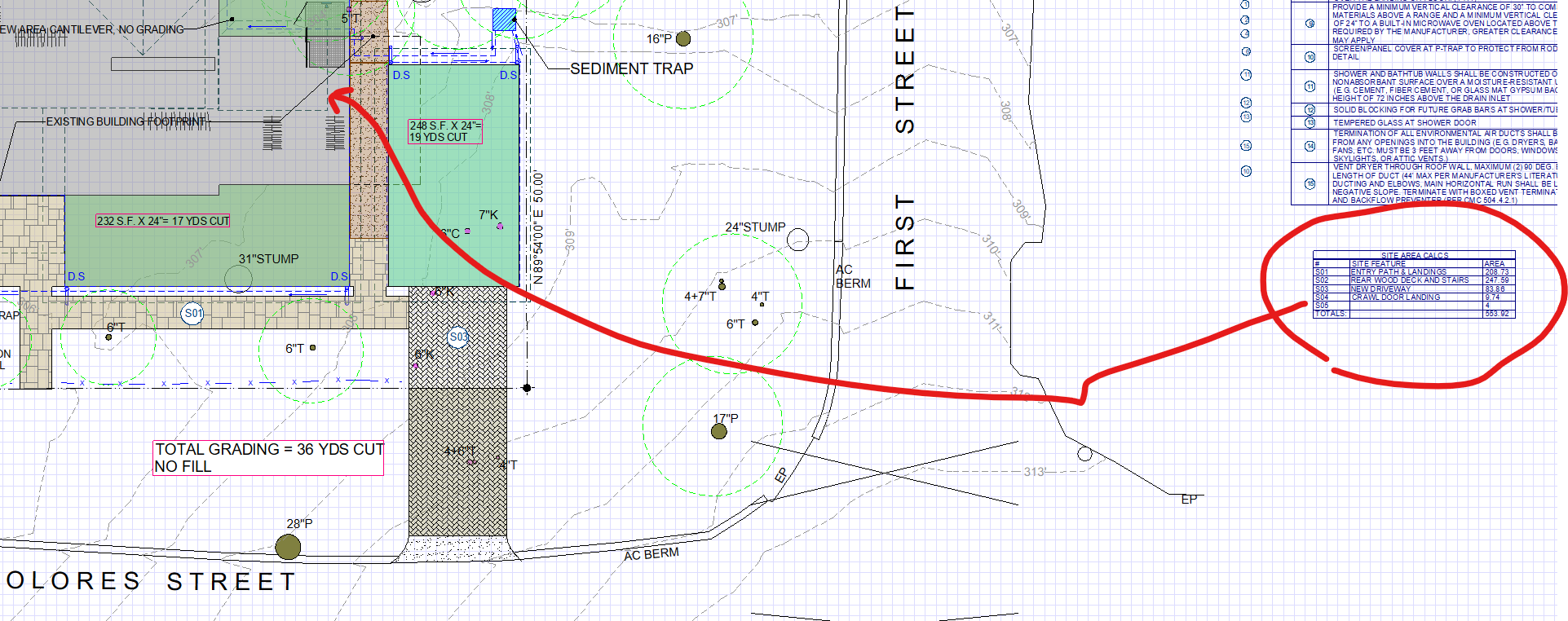

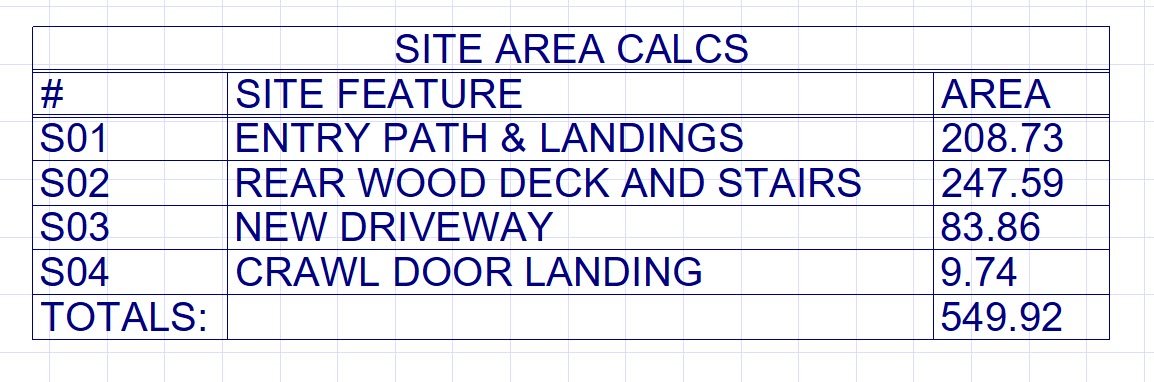

Gawdzira Posted May 14 Share Posted May 14 Hello All, I have a polyline object schedule to show my site area calcs. I have a skylight that is appearing in the schedule as a polyline since it is a ceiling opening. I have tried to change it's schedule designation but it just reverts to the default. Any ideas on how to solve it other than deleting the skylght? If you click on S05 and do a "find in plan" it appears. https://www.dropbox.com/scl/fi/pdskzcz281xqbxnxcfwta/Renaud-CNCPT-V1.plan?rlkey=rpl9rj8j3968lwvcook3e14ia&dl=0 Thanks, Alan Link to comment Share on other sites More sharing options...

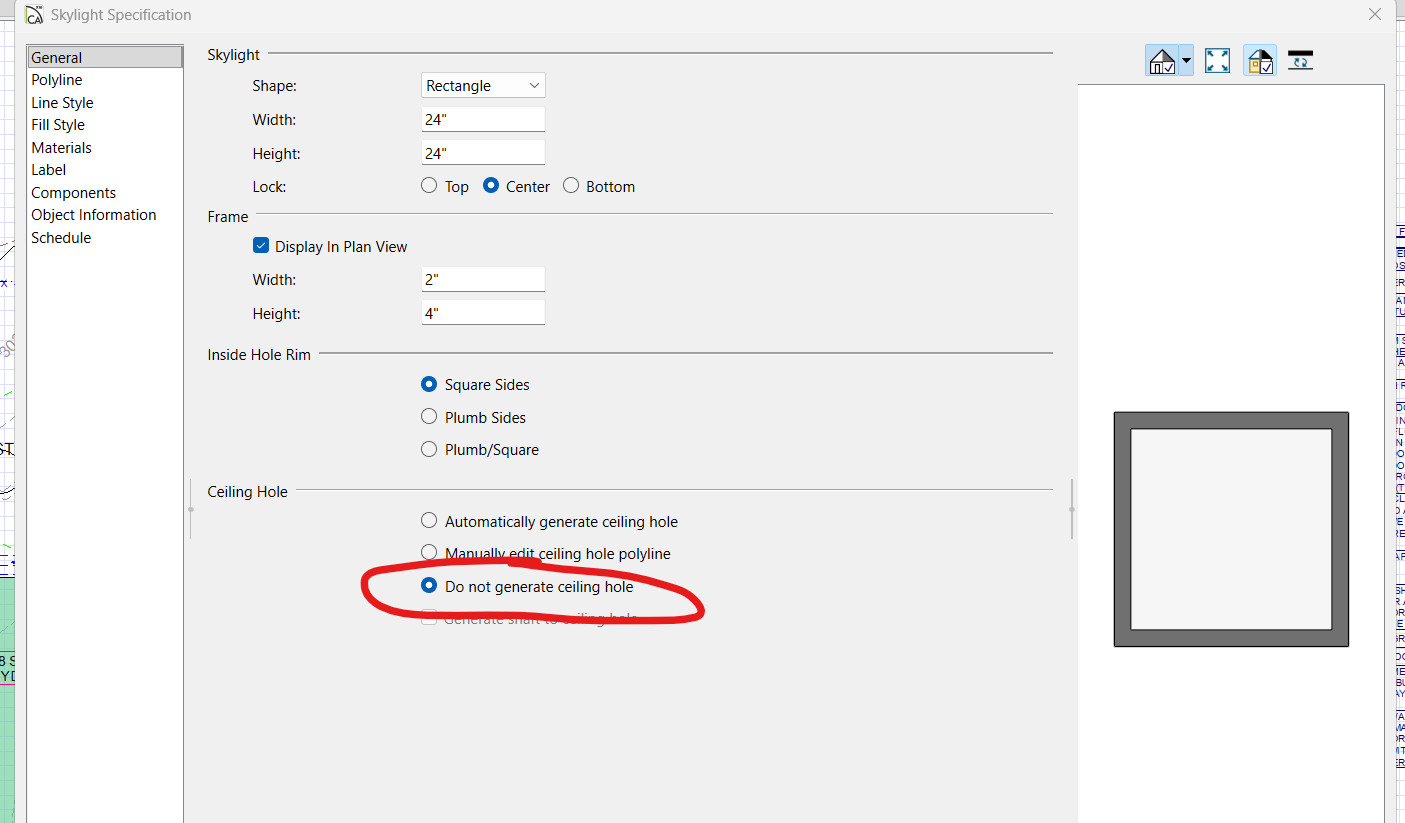

Gawdzira Posted May 14 Author Share Posted May 14 I found a solution but I don't like it. Link to comment Share on other sites More sharing options...

Alaskan_Son Posted May 15 Share Posted May 15 Okay, I opened in X16 and see what you mean. If it were me and I were stuck using X16, I would have your other polylines report to a Custom Schedule category. I think that is more fitting anyway since they're being used for a unique purpose. 1 Link to comment Share on other sites More sharing options...
Gawdzira Posted May 16 Author Share Posted May 16 Thanks for checking. That sounds like a better strategy. 1 Link to comment Share on other sites More sharing options...
