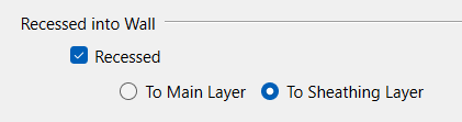

SHCanada2 Posted yesterday at 04:31 AM Share Posted yesterday at 04:31 AM (edited) The core catalog E21 shows proud for some reason I think I either fixed this before(as the "correct" E21 door is in my user catalog, shows as E21A int he video ). I do not see a setting, and simply changing to the E21 Door, you can see in the preview that it pops out. Is there a setting I am missing. They both show as Reccessed->Sheathing layer: 25.04.2026_22.31.46_REC.mp4 Edited yesterday at 04:32 AM by SHCanada2 Link to comment Share on other sites More sharing options...

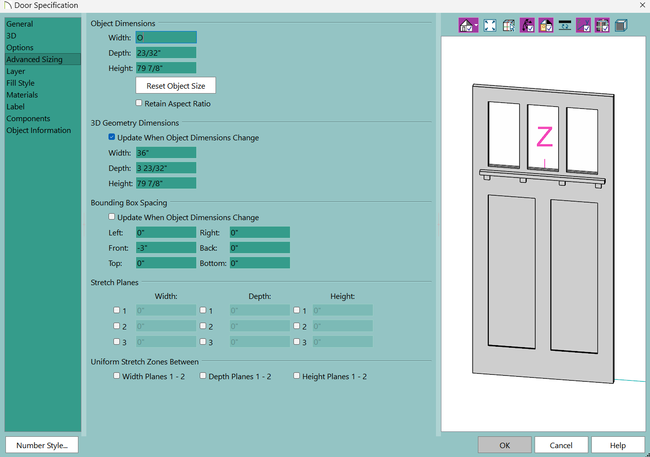

MollyNDG Posted 6 hours ago Share Posted 6 hours ago (edited) Copying it to the user library you can open it up and see in the bounding box space the front is set to -3", if you set to 0" it works properly. Seems like a mistake in the symbol in the library, probably best to report it to Chief so that they can fix it. Edited 6 hours ago by MollyNDG Link to comment Share on other sites More sharing options...
