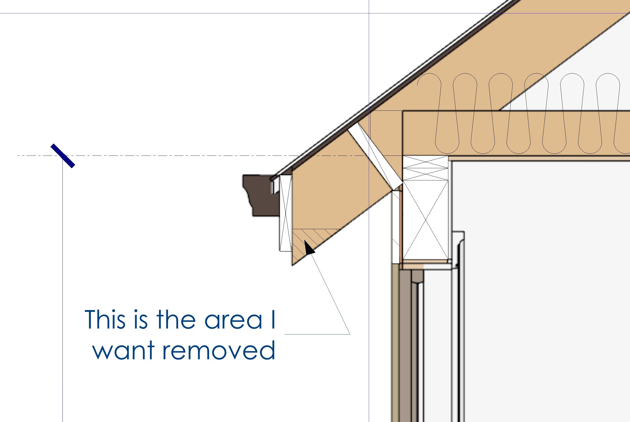

cjanderson66 Posted March 31 Share Posted March 31 Once again I am sure this is a simple process, but I seem to have difficulty with this. How do I get my tails to have a 6" flush cut instead of extending below the fascia board? I do not want a subfascia. Link to comment Share on other sites More sharing options...
Chrisb222 Posted March 31 Share Posted March 31 22 minutes ago, cjanderson66 said: How do I get my tails to have a 6" flush cut instead of extending below the fascia board? Do you have "Soffits" unchecked? Soffits cut the lower tip of the rafter tail. If you don't want a soffit, use Insulation Air Gap as its material. 1 Link to comment Share on other sites More sharing options...
cjanderson66 Posted March 31 Author Share Posted March 31 That worked Chris. Thanks, Link to comment Share on other sites More sharing options...
