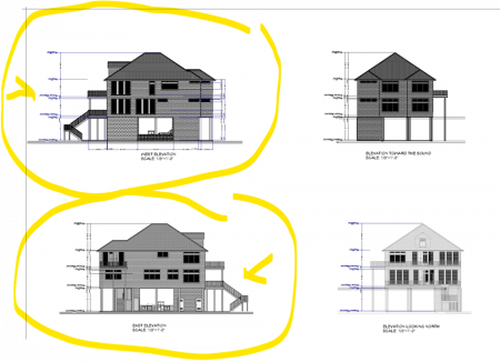

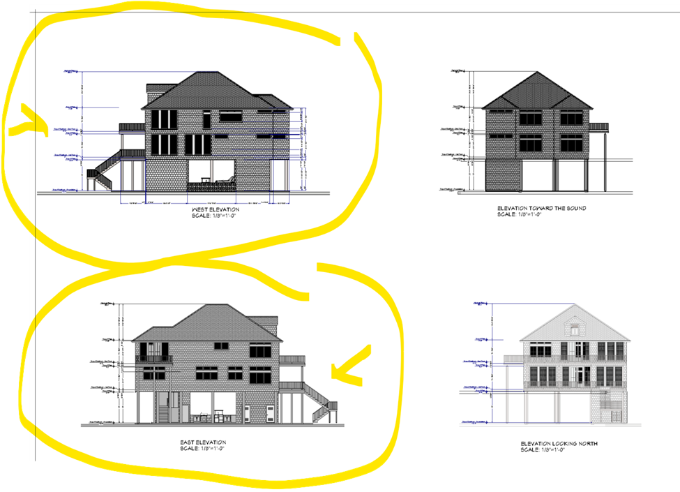

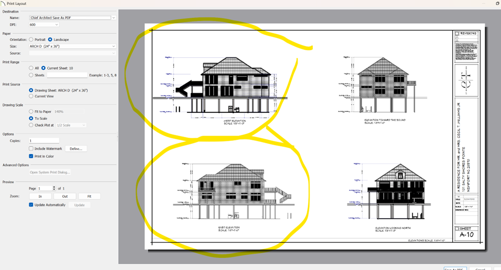

Evolution Posted March 26 Share Posted March 26 Trying to print Permit set for the AHJ (need to have it ready today 3/26/2026) for a 2 1/2 drive to the Building dept office. Have no clue what happened. Here's what the layout looks like. Then I get this for my print preview...............the steps to the deck suddenly jumped to the next floor up. This hasn't happened before. I didn't change anything on the printer settings. Can anyone help? COASTAL RESIDENCE FOR CECIL and HELEN WILLIAMS FOR PERMIT.zip Link to comment Share on other sites More sharing options...
Solution Joe_Carrick Posted March 26 Solution Share Posted March 26 (edited) In the Layout for that page - Update View(s) Edited March 26 by Joe_Carrick 1 Link to comment Share on other sites More sharing options...
