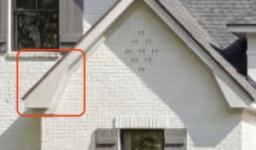

PitMan71 Posted March 25 Share Posted March 25 What is the best way to achieve a gable angled bird box like this? its kind of a French country look. Thanks Link to comment Share on other sites More sharing options...

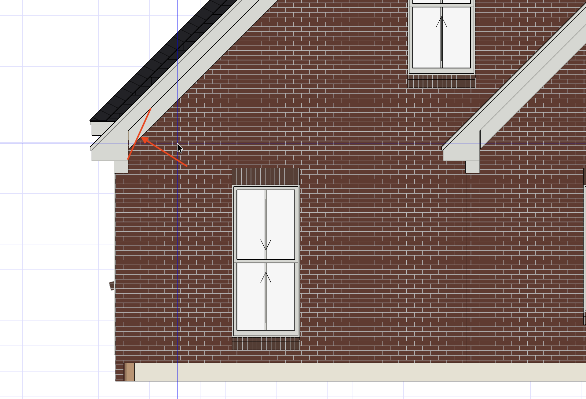

winterdd Posted March 25 Share Posted March 25 copy and paste in place roof plane. Slide the two planes to connect at the pitch break and then manipulate the lower portion to the pitch desired. If I am understanding you right. Kind of similar to how I do a flared eave but opposite. 1 Link to comment Share on other sites More sharing options...
GeneDavis Posted March 25 Share Posted March 25 A solid would be quick and easy. I always use CAD detail from view so as to be able to cleanly snap the lines where needed, then cut and paste it into live to make the solid. 1 Link to comment Share on other sites More sharing options...
PitMan71 Posted March 25 Author Share Posted March 25 4 hours ago, winterdd said: copy and paste in place roof plane. Slide the two planes to connect at the pitch break and then manipulate the lower portion to the pitch desired. If I am understanding you right. Kind of similar to how I do a flared eave but opposite. Thanks for the response..... It's actually an angled bird box. The roof itself doesn't change. I attached a photo. Link to comment Share on other sites More sharing options...
PitMan71 Posted March 25 Author Share Posted March 25 2 hours ago, GeneDavis said: A solid would be quick and easy. I always use CAD detail from view so as to be able to cleanly snap the lines where needed, then cut and paste it into live to make the solid. That's what I was thinking. I just didn't want to have to do that if there was something baked in. Thanks Link to comment Share on other sites More sharing options...
