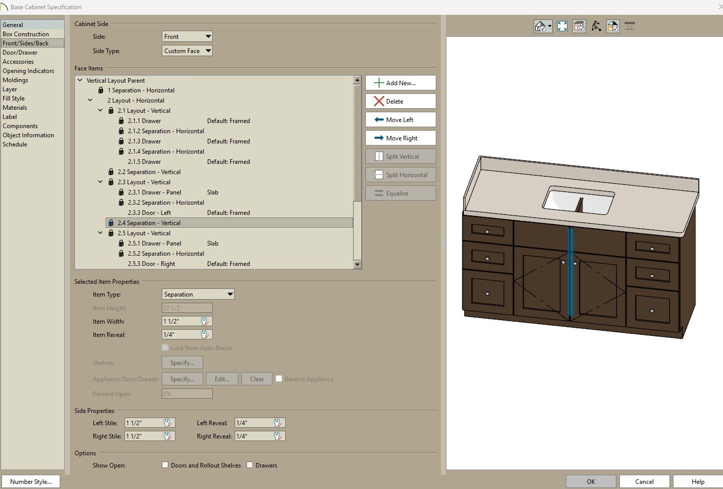

TJDDesigns Posted February 27 Share Posted February 27 Hi All, I have searched everywhere for a solution to this sink issue. I have a vanity with a separation showing in the middle of the sink because of having (2) false panels instead of (1). How can I have a separation of the false panels, just on the face, but not have it cut through the sink? I am attaching (2) images for reference. (X17) Thanks in advance! Link to comment Share on other sites More sharing options...

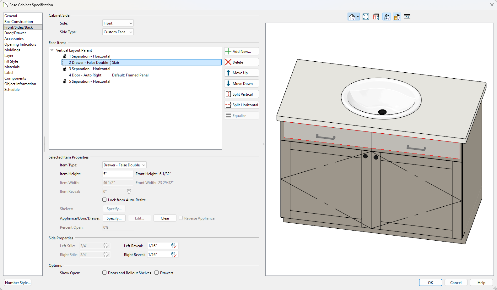

DBCooper Posted February 27 Share Posted February 27 (edited) Instead of splitting the face to get two false drawers, just make it double false drawer. Edited February 27 by DBCooper Link to comment Share on other sites More sharing options...
MarkMc Posted February 28 Share Posted February 28 Change separation to a blank area, then make narrower to the size of your reveal Link to comment Share on other sites More sharing options...
TJDDesigns Posted March 1 Author Share Posted March 1 Changing it to a blank area and adjusting the width worked great. Thanks! Link to comment Share on other sites More sharing options...
