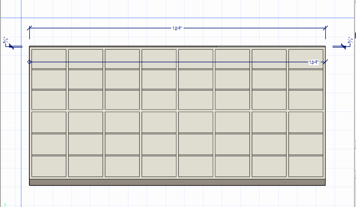

jacpdx Posted February 25 Share Posted February 25 Hi, I cannot get auto-dimensioning to work for this set of built-in bookshelves; I only get the dimensions shown below. Same for running dimensions, when I drag to do running dimensions, it does not pick up each rail or stile. The only thing that seems to work is point-to-point. Thanks for the help. John studio built-ins.plan Link to comment Share on other sites More sharing options...
DBCooper Posted February 25 Share Posted February 25 Open the active dimension defaults. You should get them when you double click on the dimension tool. Assuming you want to use the manual dimension tool, look for the "locate manual" settings. Look for the cabinet settings and turn on "openings". I think this will give you want you are looking for. 1 Link to comment Share on other sites More sharing options...
Solution jacpdx Posted March 1 Author Solution Share Posted March 1 (edited) On 2/25/2026 at 10:01 AM, DBCooper said: Open the active dimension defaults. You should get them when you double click on the dimension tool. Assuming you want to use the manual dimension tool, look for the "locate manual" settings. Look for the cabinet settings and turn on "openings". I think this will give you want you are looking for. Apologies for not responding sooner... I made the changes you suggested, and it works great. Thank you Edited March 1 by jacpdx Link to comment Share on other sites More sharing options...
