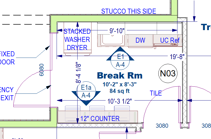

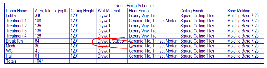

ACADuser Posted February 8 Share Posted February 8 I would like the wall material to show only the material inside that room. Can that be done? The exterior walls display stucco which I do not want to see in the schedule. Link to comment Share on other sites More sharing options...

ACADuser Posted February 8 Author Share Posted February 8 (edited) Not all rooms do this? [Edit] I just sent it to tech support. Edited February 8 by ACADuser Link to comment Share on other sites More sharing options...

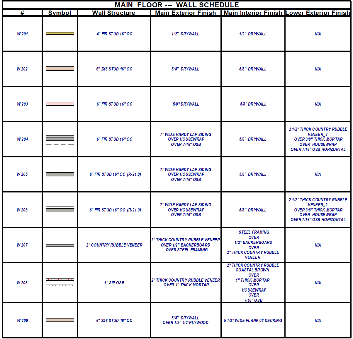

Joe_Carrick Posted February 8 Share Posted February 8 (edited) This can happen when there are multiple wall types surrounding the room, including pony walls. In your case, it's the wall with the lable "STUCCO THIS SIDE". Check that wall definition - maybe reverse the wall layers. Personally I don't use that column simply because of this. Instead I use "Wall Schedules" which can have macros to display all the wall layers. Edited February 8 by Joe_Carrick Link to comment Share on other sites More sharing options...
ACADuser Posted February 8 Author Share Posted February 8 Thanks Joe, I've messed with the 3 wall intersection with no luck. You solution will solve my problem. Link to comment Share on other sites More sharing options...

Joe_Carrick Posted February 8 Share Posted February 8 (edited) 4 hours ago, PitMan71 said: It's irritating to me to have to throw the baby out with the bathwater. in this case people will avoid using an entire column because it can't be relied on to provide the information needed. The problem's that there's no column for individual walls of a room. If there was at least 4: North or 1 East or 2 South or 3 West or 4 It would be possible to have a fully functional Finish Schedule. You can have custom fields for those and manually assign the values for each room. It's a little more work but the Schedule would be more interesting. Edited February 8 by Joe_Carrick 1 Link to comment Share on other sites More sharing options...

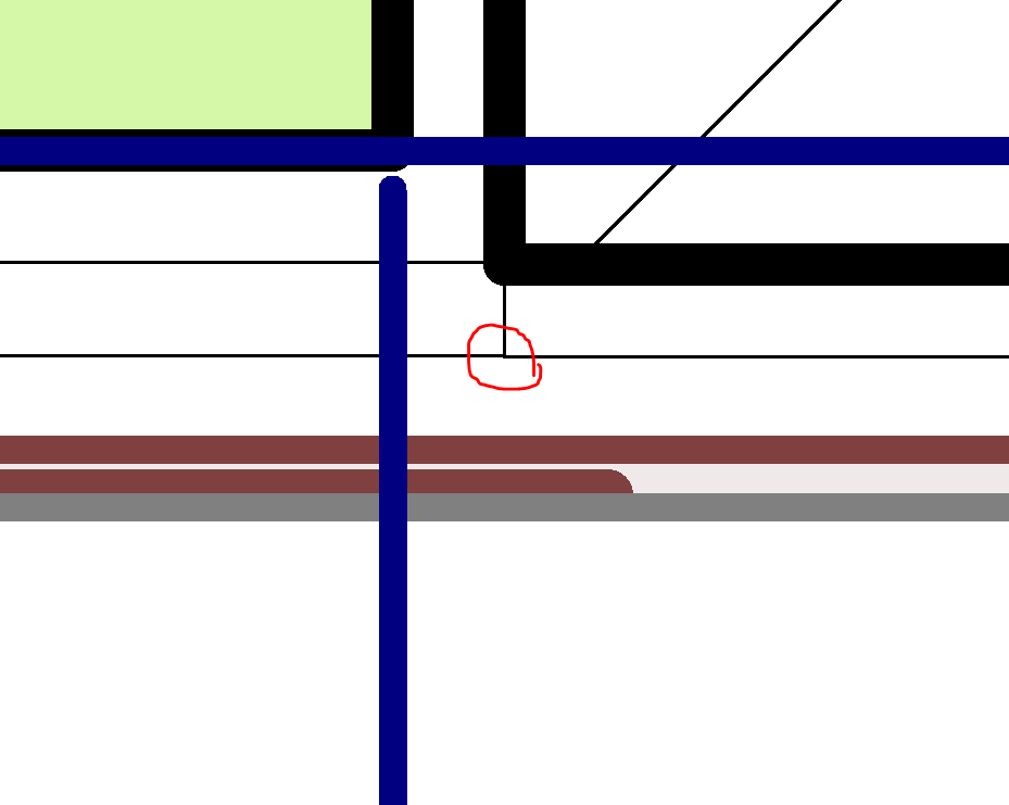

ACADuser Posted February 10 Author Share Posted February 10 Tech support suggested moving the thin wall slightly to auto align with the thicker wall. This did not work for me. I was able to turn temp dimensions off & zoom in very tight and point-to-point move the thin wall. That fixed the room table. You can see how small the misalignment was! 1 Link to comment Share on other sites More sharing options...
