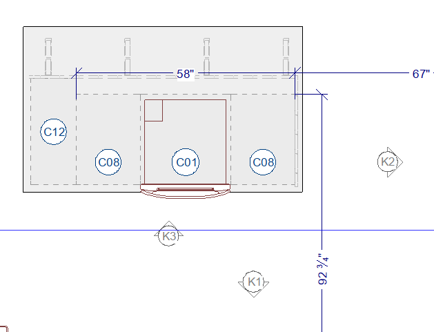

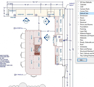

GeneDavis Posted February 2 Share Posted February 2 I'm using out of the box X17 and having trouble understanding how to change text size for 2D camera views, both backclipped and wall elevation. Here is a screenshot of my cabinet plan for a kitchen with island. K1 and K2 were taken as wall elevations, and K3 is a backclipped section view. Note the size of the text in these is same as the cabinet callouts, and same as the dimensions shown. They are all sized for the K&B plan view. Now take a look at a screencap from a Chief video on the top of annotation using default sets, this one using the K&B view of a kitchen. Note the text size for the walls and section view. That's what I want. Larger. How do I get there. Link to comment Share on other sites More sharing options...

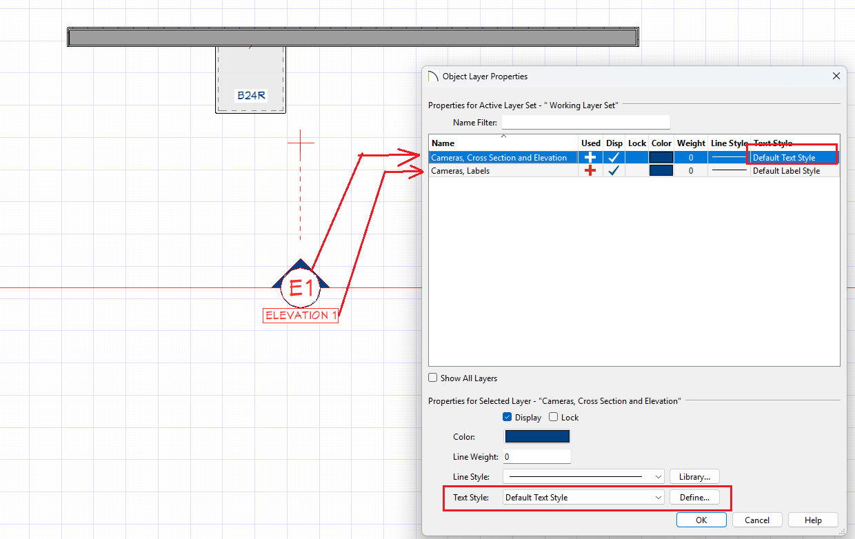

Solution DBCooper Posted February 2 Solution Share Posted February 2 I think the camera callouts will always use the text style for the camera layer, not the camera label layer. Link to comment Share on other sites More sharing options...
