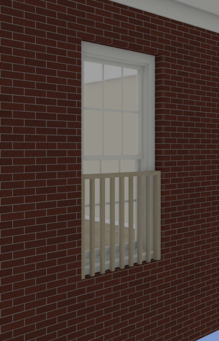

AnkhRea Posted January 27 Share Posted January 27 Hello, I am new with CA. I want to make a window that start from floor level and add a railing directly in the window frame as on the photo. (No balcony) I didn't find how to do it. Every time I am using the railing tool, my windows disappeared. I tried to wider the frame. Can someone help me... Thank you Link to comment Share on other sites More sharing options...

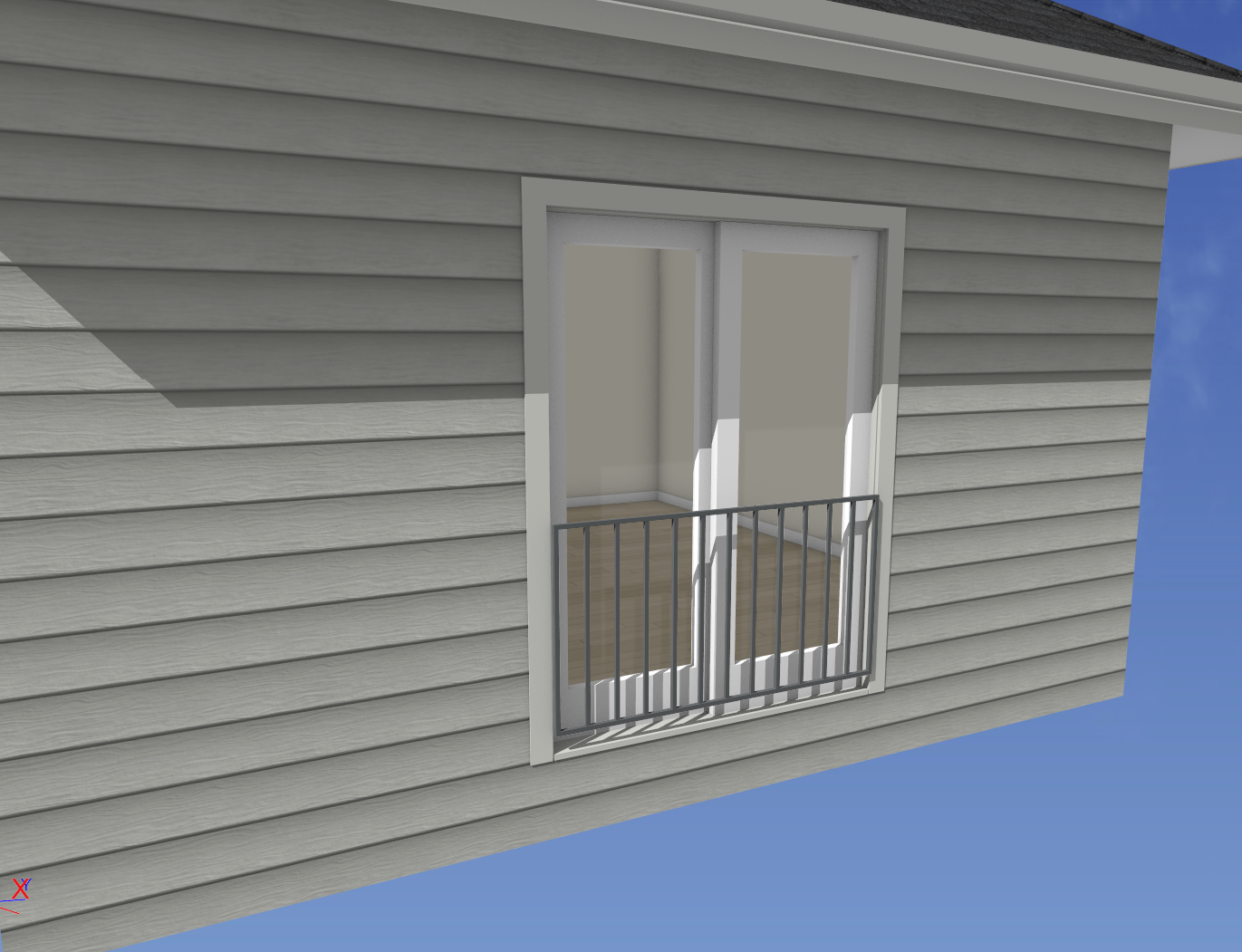

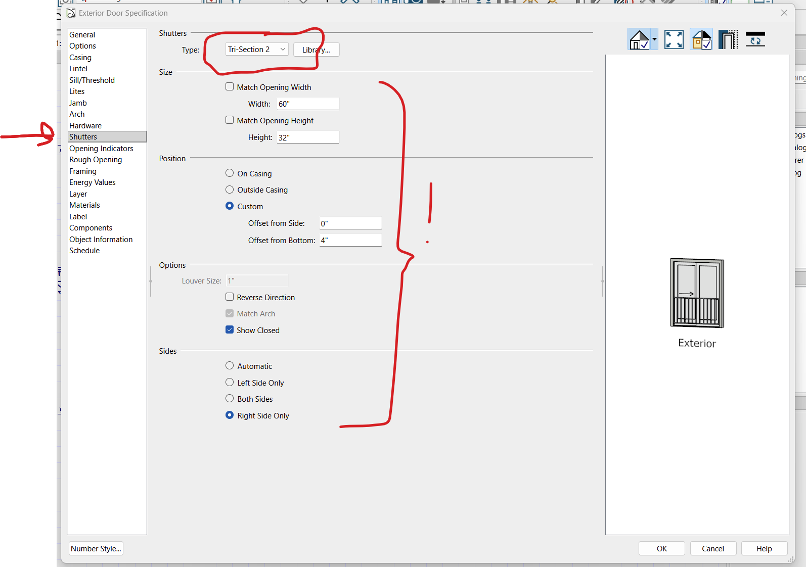

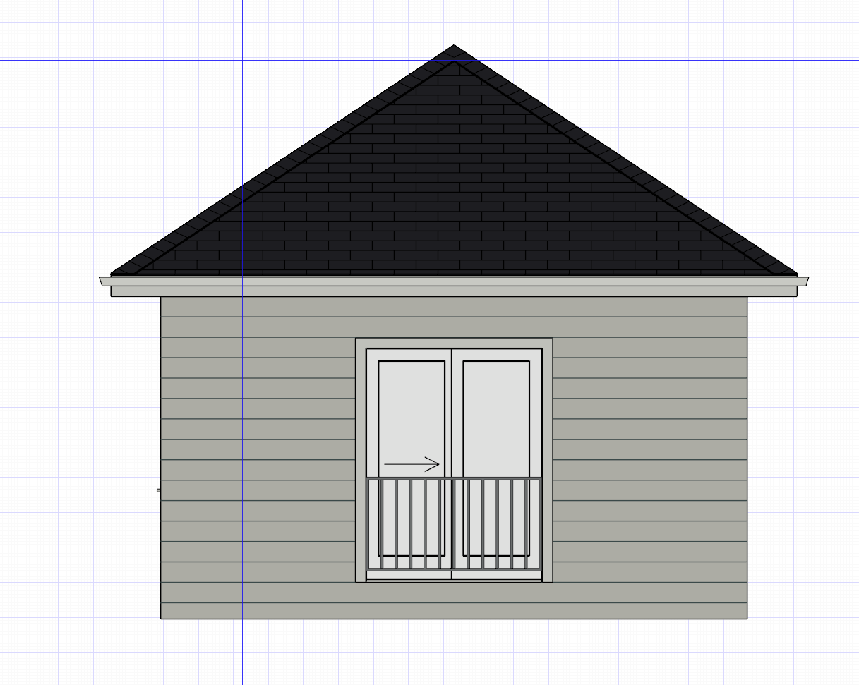

JKEdmo Posted January 27 Share Posted January 27 Juliette Balcony. How about doing it as a door shutter? Result seems pretty dang good: 1) Slider door. 2) Select railing from library as the shutter type. Shutter on one side only. 3) Tweak shutter settings for desired result. 3 2 Link to comment Share on other sites More sharing options...
