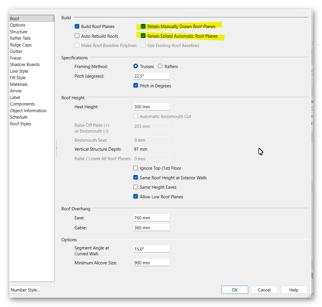

Mark3D Posted January 22 Share Posted January 22 I know you have it done but would these setting been of use Link to comment Share on other sites More sharing options...
builtright3 Posted January 23 Author Share Posted January 23 4 hours ago, Mark3D said: I know you have it done but would these setting been of use Yes, that was what I was looking for. Not sure why I didnt see it when I was looking. Thank You Link to comment Share on other sites More sharing options...
