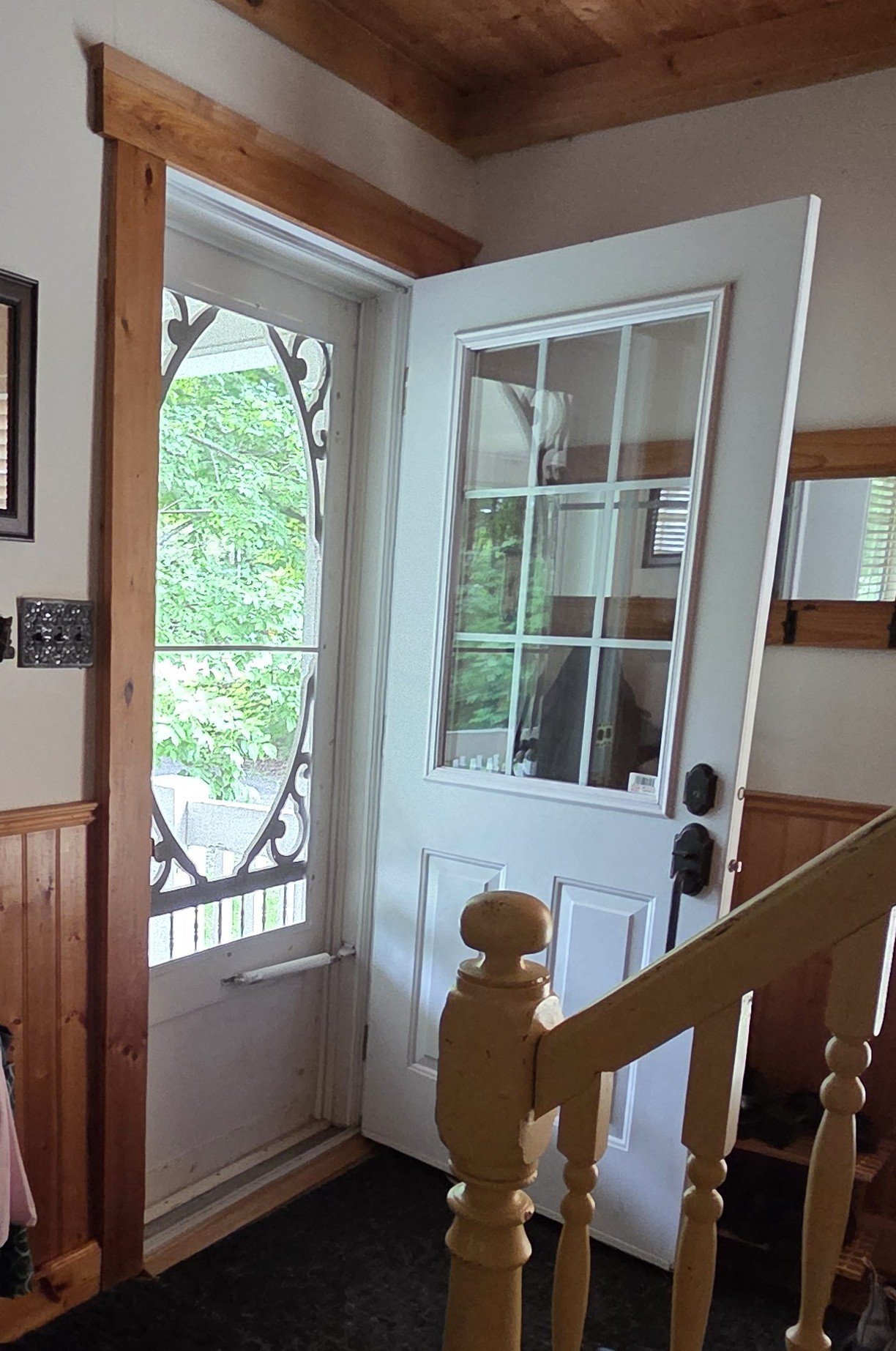

DanielleDubuc Posted 4 hours ago Share Posted 4 hours ago Hi, I am currently drawing an existing plan and I would like to know how to draw 2 doors one behind the other in the same casing. One opening to the inside and the other opening to the exterior. It is not a double swing door, there are actually 2 doors. See the picture below. I have been trying the double stud wall type with no success, neither with 2 walls side by side. Thanks in advance Link to comment Share on other sites More sharing options...
JKEdmo Posted 4 hours ago Share Posted 4 hours ago 4 minutes ago, DanielleDubuc said: Hi, I am currently drawing an existing plan and I would like to know how to draw 2 doors one behind the other in the same casing. One opening to the inside and the other opening to the exterior. It is not a double swing door, there are actually 2 doors. See the picture below. I have been trying the double stud wall type with no success, neither with 2 walls side by side. Thanks in advance Danielle, You can copy the second door in place and redefine swing, style, etc. as needed. - Jim Link to comment Share on other sites More sharing options...
mtldesigns Posted 1 hour ago Share Posted 1 hour ago 2 hours ago, DanielleDubuc said: draw 2 doors one behind the other in the same casing Yep, just like Jim states. I always create this door to the side, make any changes (like turn off all casings, jambs, and lintels). Cut and paste to its new location. Easy Peasy. Link to comment Share on other sites More sharing options...
