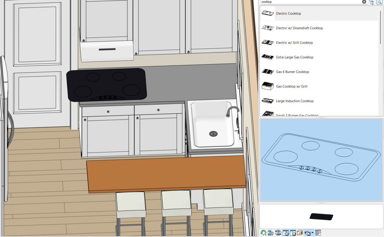

GiantRenovations Posted January 6 Share Posted January 6 I am doing a plan for a tiny home and want to place a small cooktop on a base cabinet. The default size for an electric cooktop is 36". Unlike other appliances there is no way to select the item and manually change the dimensions. The 24" cabinet was already in place and there are no options to select the cooktop nor change any options under "accessories" of the cabinet. Can the existing cooktop be changed? Or is there any way to put in a 24" electric cooktop? Link to comment Share on other sites More sharing options...
GaryOhmer Posted January 6 Share Posted January 6 subzero - wolf library has 3 burner induction cooktop 24" wide Link to comment Share on other sites More sharing options...
GiantRenovations Posted January 6 Author Share Posted January 6 8 minutes ago, GaryOhmer said: subzero - wolf library has 3 burner induction cooktop 24" wide Thanks. That worked! Link to comment Share on other sites More sharing options...
GaryOhmer Posted January 6 Share Posted January 6 core - architectural - small appliances - vertical dual - element cooktop will fit Link to comment Share on other sites More sharing options...
DBCooper Posted January 7 Share Posted January 7 Quote Unlike other appliances there is no way to select the item and manually change the dimensions. Actually, there are a few ways to do this. You can just use the tab key to select the cooktop after you have selected the cabinet. Then you can resize it using the edit handles or use "open object" to do it through the fixture dialog. You can also use the "open symbol" edit toolbar button when you have selected the cabinet. You can even edit if from the cabinet dialog by going to the "accessories" page and looking for the edit button next to the "top appliance". Link to comment Share on other sites More sharing options...
