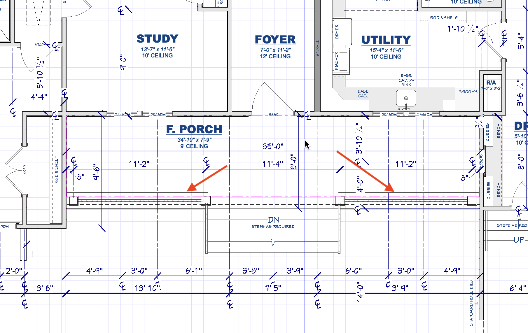

PitMan71 Posted November 25 Share Posted November 25 Hello all. Working on finalizing some plans and have a mystery line created by the railing wall that I can't seem to figure out how to hide.... Doesn't seem to be added when I just add another railing wall like it. The line is on the inside face of the rail wall. The file is large so the link is below.https://www.dropbox.com/scl/fi/gkwucv2maj9d464m1k2my/44-250020.plan.zip?rlkey=od38oldhvwo357ffbpp5836s5&dl=0 Thanks in advance for the help figuring this out. Link to comment Share on other sites More sharing options...

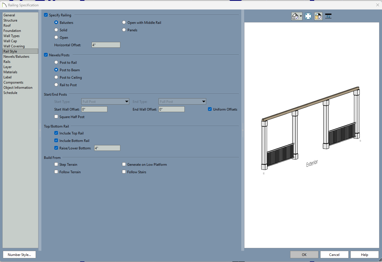

robdyck Posted November 25 Share Posted November 25 That line is the overall thickness of the railing wall. Railings (almost) always display lines on both edges. You'll need to get creative to get rid of that line. Try making the wall thickness 8" so that the interior line is buried in the center of the railing wall. Offset the railing by 4". 1 Link to comment Share on other sites More sharing options...

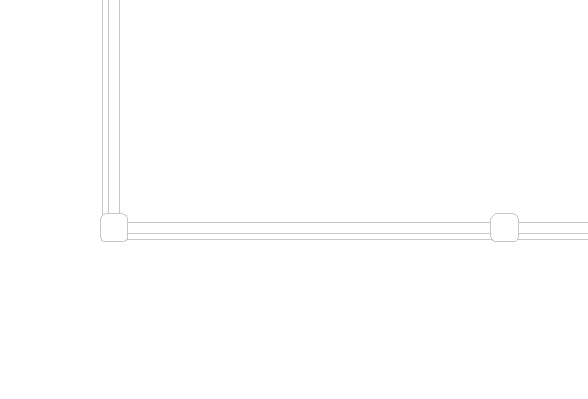

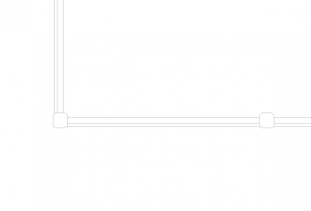

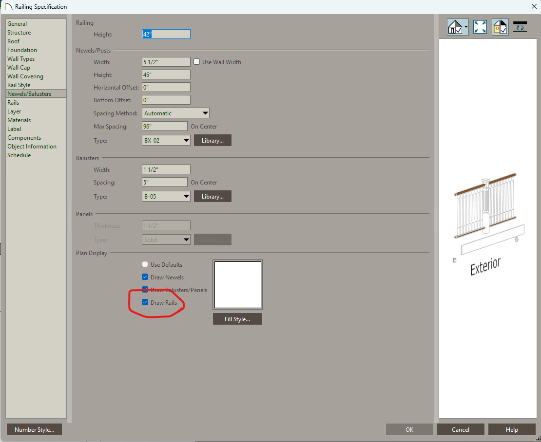

Renerabbitt Posted November 25 Share Posted November 25 1 hour ago, robdyck said: You'll need to get creative to get rid of that line This will get rid of it and draw a rail instead: 2 Link to comment Share on other sites More sharing options...
