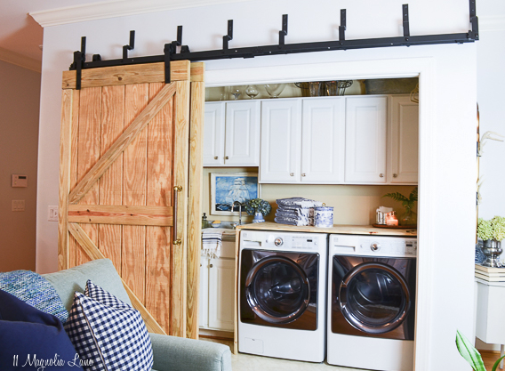

JKEdmo Posted November 21, 2025 Share Posted November 21, 2025 Hi, Does Chief allow a stacking barn door option like in the picture below? Thanks, Link to comment Share on other sites More sharing options...
PitMan71 Posted November 21, 2025 Share Posted November 21, 2025 I don't see anything baked in. What I would do in this situation is put two barn doors together and do a panel offset on one to bring it out a little further than the other door say like 3". Then mull them and let the door symbol cover the mull in the middle. Link to comment Share on other sites More sharing options...
JKEdmo Posted November 21, 2025 Author Share Posted November 21, 2025 2 hours ago, PitMan71 said: I don't see anything baked in. What I would do in this situation is put two barn doors together and do a panel offset on one to bring it out a little further than the other door say like 3". Then mull them and let the door symbol cover the mull in the middle. Thanks Shane. I'll post this as a suggestion to Chief on the forum. Funny, there was a post back in August about this which I made a similar suggestion to yours. Totally forgot - I must be losing my mind! Jim 1 Link to comment Share on other sites More sharing options...

JKEdmo Posted November 23, 2025 Author Share Posted November 23, 2025 2 minutes ago, PitMan71 said: I would love to see what Gary posted, but I am on X16. It's basically a workaround -- a combination of two barn doors and a door opening. I hope Chief considers adding this feature to barn doors. Seems like they already have the programming done for other door options like sliders or pretty close at least. Link to comment Share on other sites More sharing options...
GaryOhmer Posted November 23, 2025 Share Posted November 23, 2025 here's x16 file barn door.zip 1 Link to comment Share on other sites More sharing options...
GaryOhmer Posted November 23, 2025 Share Posted November 23, 2025 (edited) x17 just using 2 barn doors barn door (2).zip Edited November 23, 2025 by GaryOhmer x 17 Link to comment Share on other sites More sharing options...
