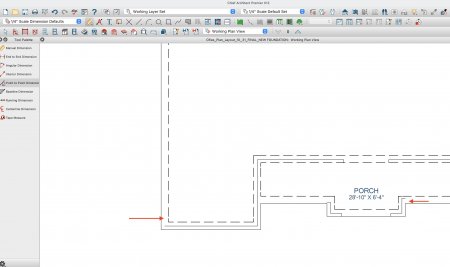

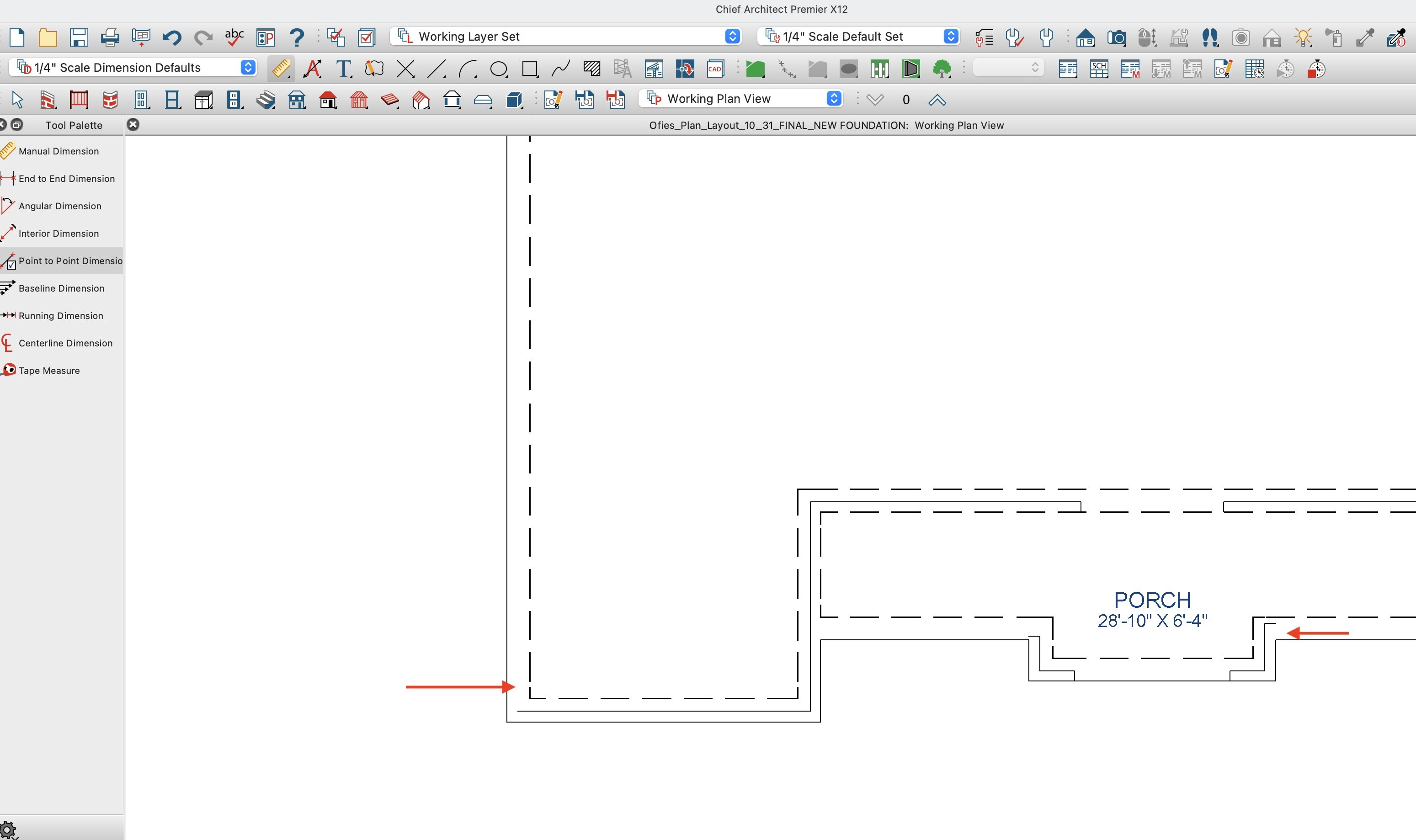

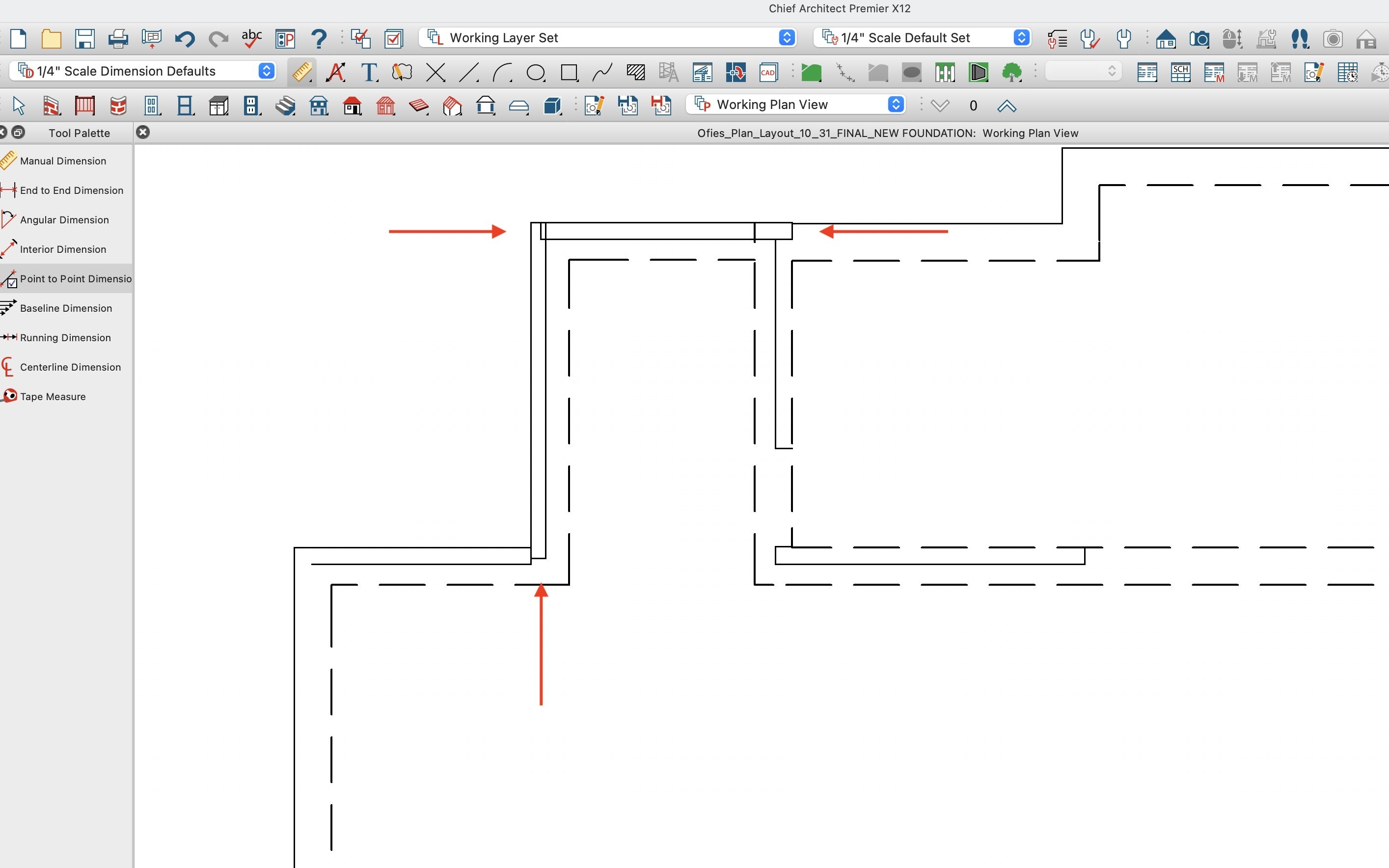

ESanchez7 Posted November 4 Share Posted November 4 I can't figure out why the 5 1/2" brick ledge won't display all the way around the foundation and then does some overlapping in other sections. Has anyone else run into something like this? Any help would be appreciated! 5 Link to comment Share on other sites More sharing options...

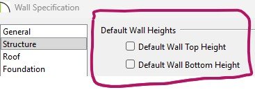

Solution scottharris Posted November 8 Solution Share Posted November 8 Looks like some of your walls were edited top or bottom. See if resetting the 'default top height' and 'default bottom height' works - on the 1st floor. Link to comment Share on other sites More sharing options...
ESanchez7 Posted November 9 Author Share Posted November 9 Thanks Scott, That fixed it! Really appreciate the help. Link to comment Share on other sites More sharing options...
