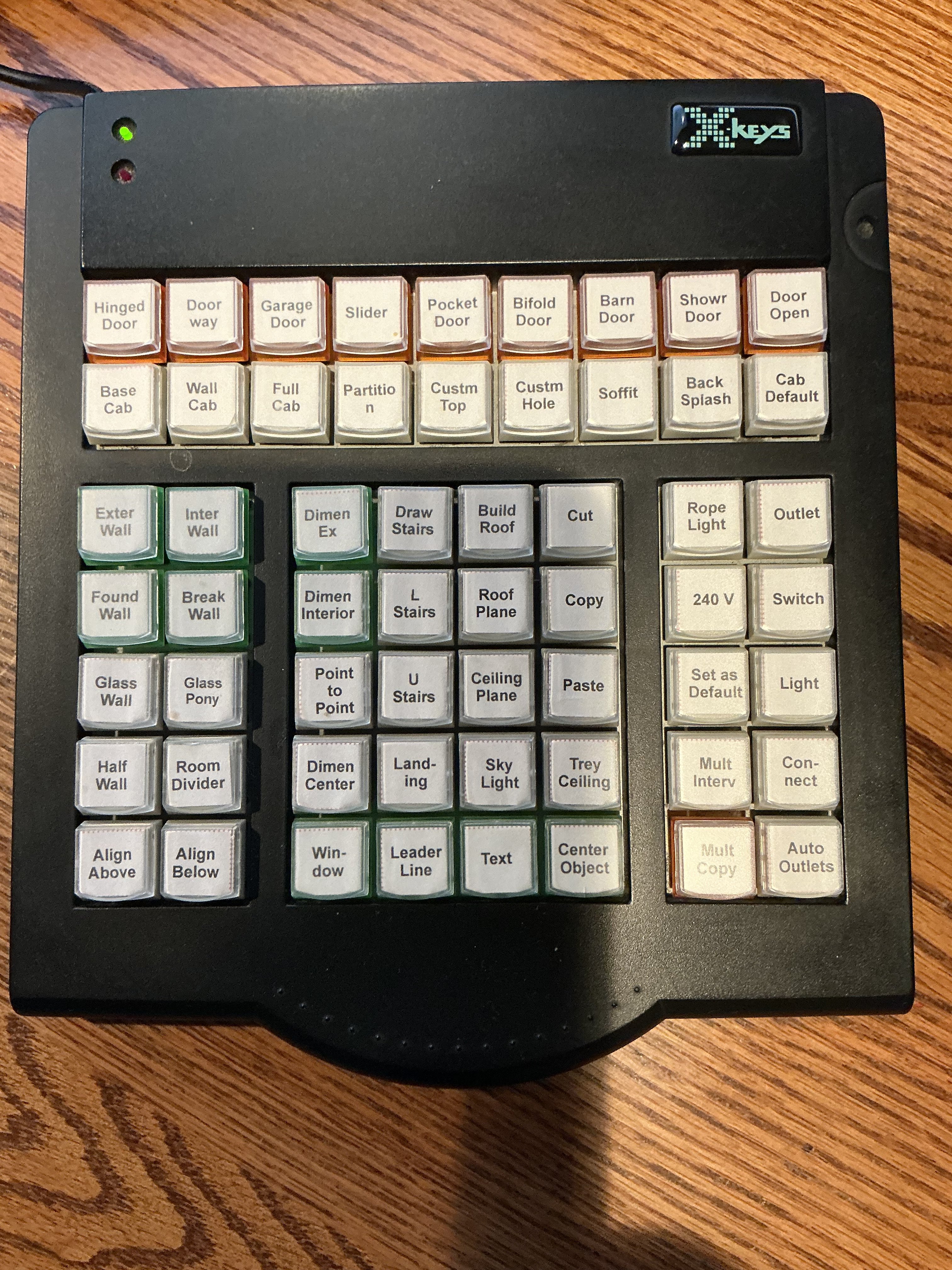

Electromen Posted November 4, 2025 Share Posted November 4, 2025 (edited) This is XKeys. I been using it for years in Chief Architect. Each key can be programmed with a shortcut or hot key. it eliminates having to use the mouse to select tools. Hit the key and the tool is selected. Anyone using something similar? Edited November 4, 2025 by Electromen 1 Link to comment Share on other sites More sharing options...
