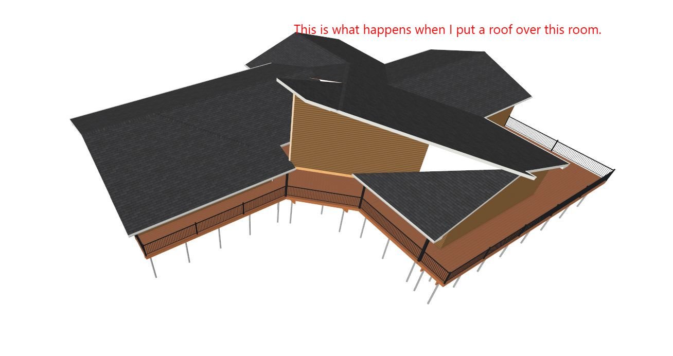

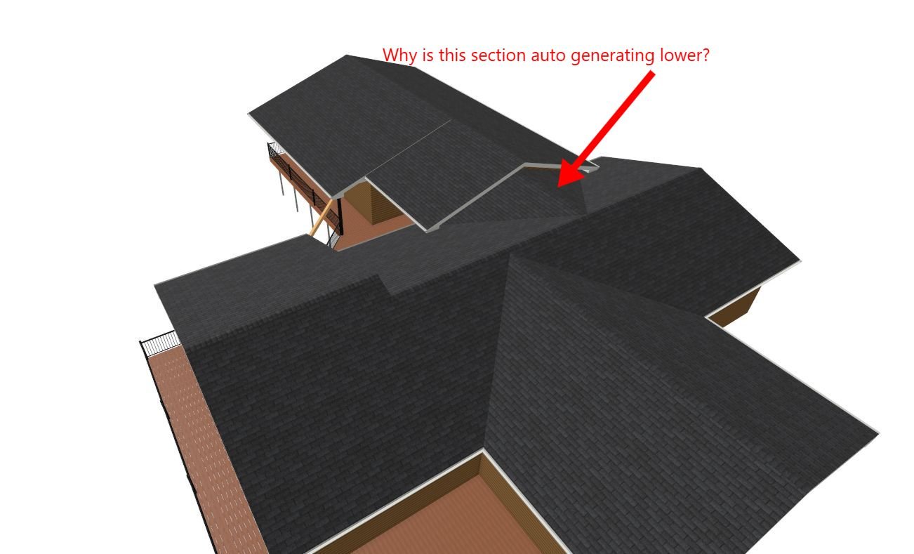

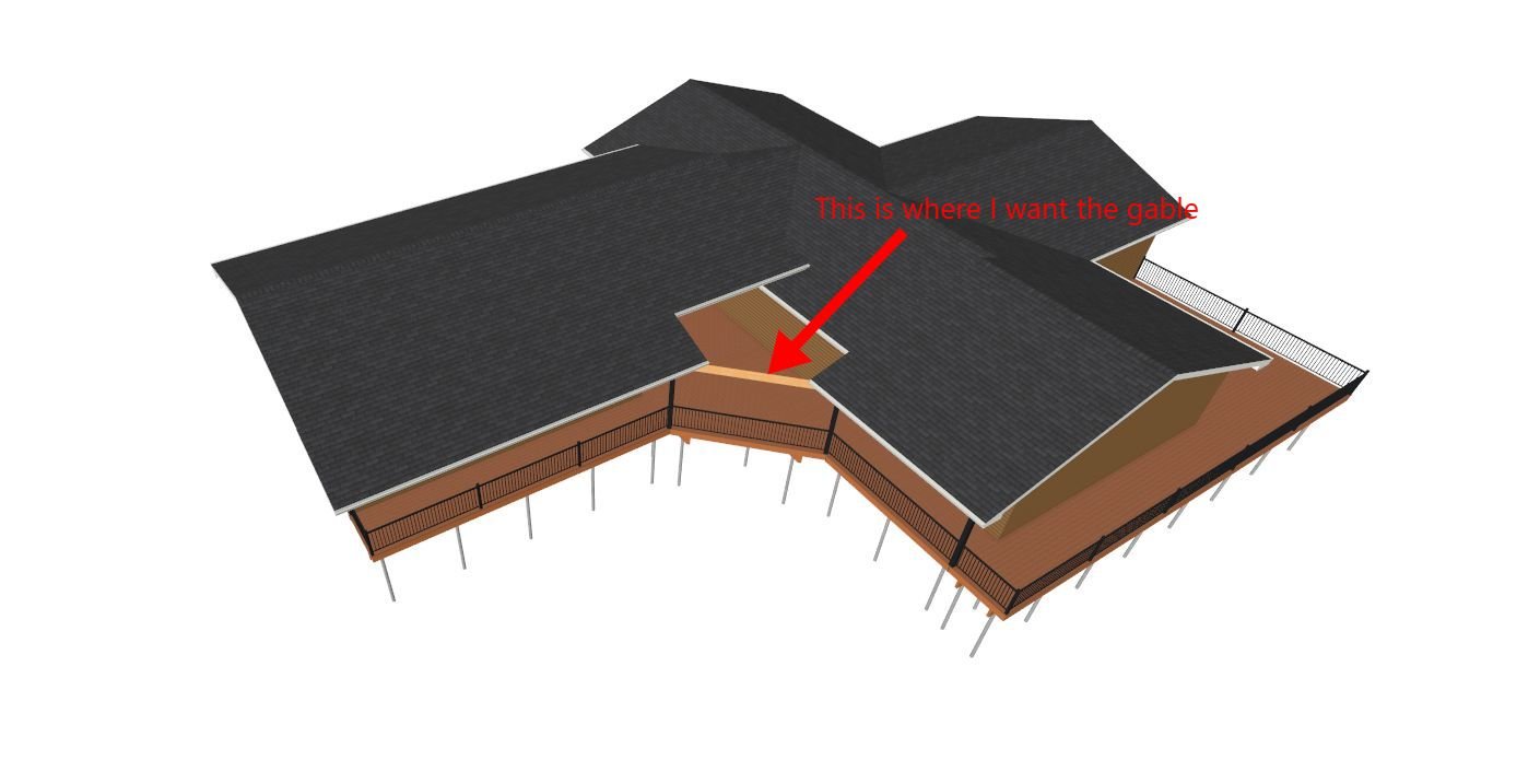

BakenUser Posted October 30, 2025 Share Posted October 30, 2025 I am working on this project and I have the roofs mostly the way I want them with the auto roofs but I have two issues. The first one is the lowered gable section where the garage roof meets the house. Any way to fix this with auto roofs? The second one is the angled section of the deck. When I put a roof over this deck with a gable on the angled section I get all kinds of funky roofs. Is there any way to do this with auto roofs or do I have to manually draw those in? Thanks for any help Link to comment Share on other sites More sharing options...

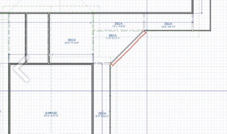

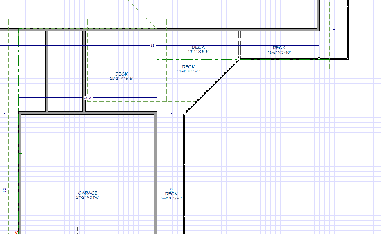

Garybills Posted October 31, 2025 Share Posted October 31, 2025 You can bump the angled railing out about a foot and add a short railing on each side to connect for the room(see picture). This will give you a gable with auto roof, but eventually you will have to turn them off I put the railing back and them manually adjust the roof planes. At least that gets you started and should help with the other issue. Link to comment Share on other sites More sharing options...
