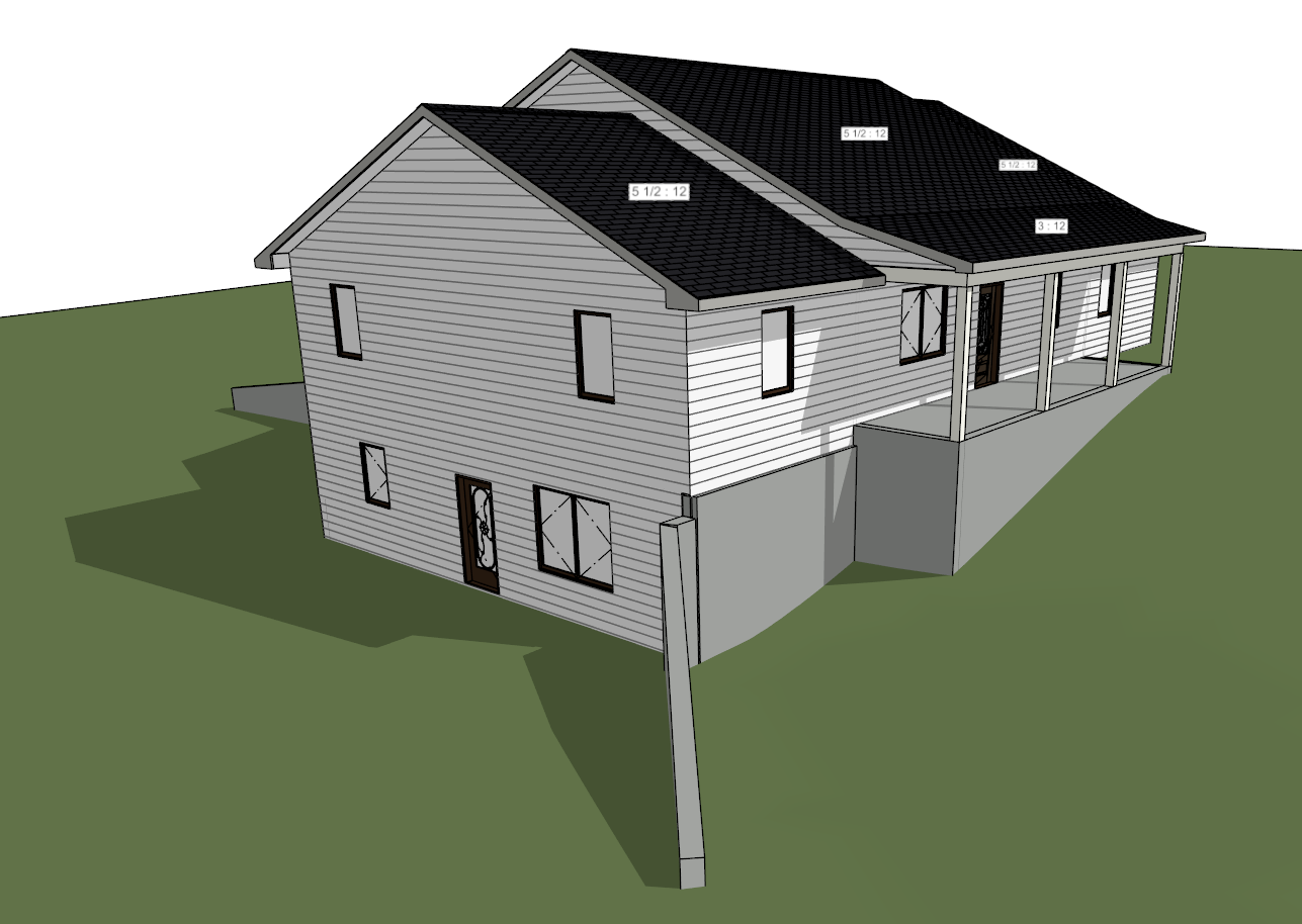

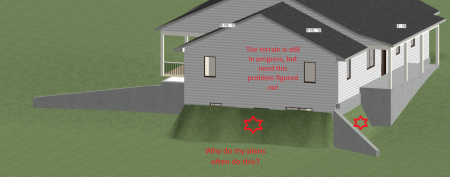

3DDesigner Posted October 28, 2025 Share Posted October 28, 2025 Why does the terrain ramp up the wall? Maybe a duh answer but I'm missing it. I've fought this before. The plan needs more work obviously and I'm on it. Plan file: https://drive.google.com/drive/folders/1g6MDjlDqXcoHZqjzO1_POAJ7WPrnaI7f?usp=sharing Thank you a lot, Russ Link to comment Share on other sites More sharing options...
SHCanada2 Posted October 28, 2025 Share Posted October 28, 2025 I'm not at my CA computer, but I assume you have terrain regions on that side as it is sloping down? looks like you need to adjust it to be next to the building. Link to comment Share on other sites More sharing options...
Solution DBCooper Posted October 28, 2025 Solution Share Posted October 28, 2025 (edited) Try turning off "flatten pad" and then lower the terrain to about -10'. Edited October 28, 2025 by DBCooper 1 Link to comment Share on other sites More sharing options...
3DDesigner Posted October 29, 2025 Author Share Posted October 29, 2025 Thank you very much Mr Cooper! Those two things fixed it right away. Link to comment Share on other sites More sharing options...
