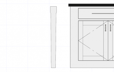

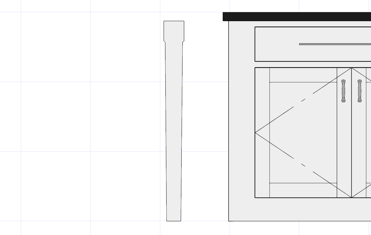

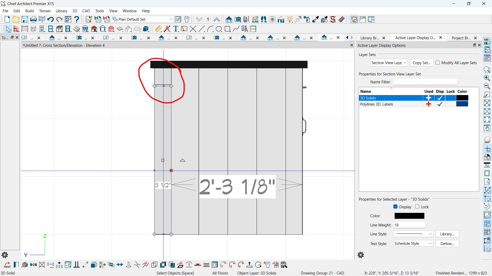

DJSSDB Posted October 23, 2025 Share Posted October 23, 2025 I am making a tapered leg for an island, and can only adjust front face. I've made a 3D solid and shaped it from the front elevation view. When I switch to an elevation from a side view, the leg, still square, is now divided into three parts that I cannot adjust. I can select each of the three parts from the side elevation; top, thin middle where the line is curved, and the long tapered leg bottom. However, I cannot place any line breaks for adjustments. Is there a fix for this? Or should I scrap and try a better method to make the leg? I'm using X15 Link to comment Share on other sites More sharing options...

DBCooper Posted October 23, 2025 Share Posted October 23, 2025 (edited) Editing the face of a poly solid in multiple elevations can get a bit funky. You might have better luck using the subtraction tool instead. Another way to create a tapered leg like that is by using moldings. If you use something like a soffit or countertop, you can add a molding profile to create the wider parts instead of cutting away the narrower parts. Edited October 23, 2025 by DBCooper Link to comment Share on other sites More sharing options...
DJSSDB Posted October 23, 2025 Author Share Posted October 23, 2025 Thanks DBCooper. It is definitely funky, haven't encountered that before. I only need it for shop drawings on this one, so I may just spin the leg for the side elevation and call it good. (The 1/4" taper is imo an unnecessary corner detail on this thing anyway... ) Link to comment Share on other sites More sharing options...
