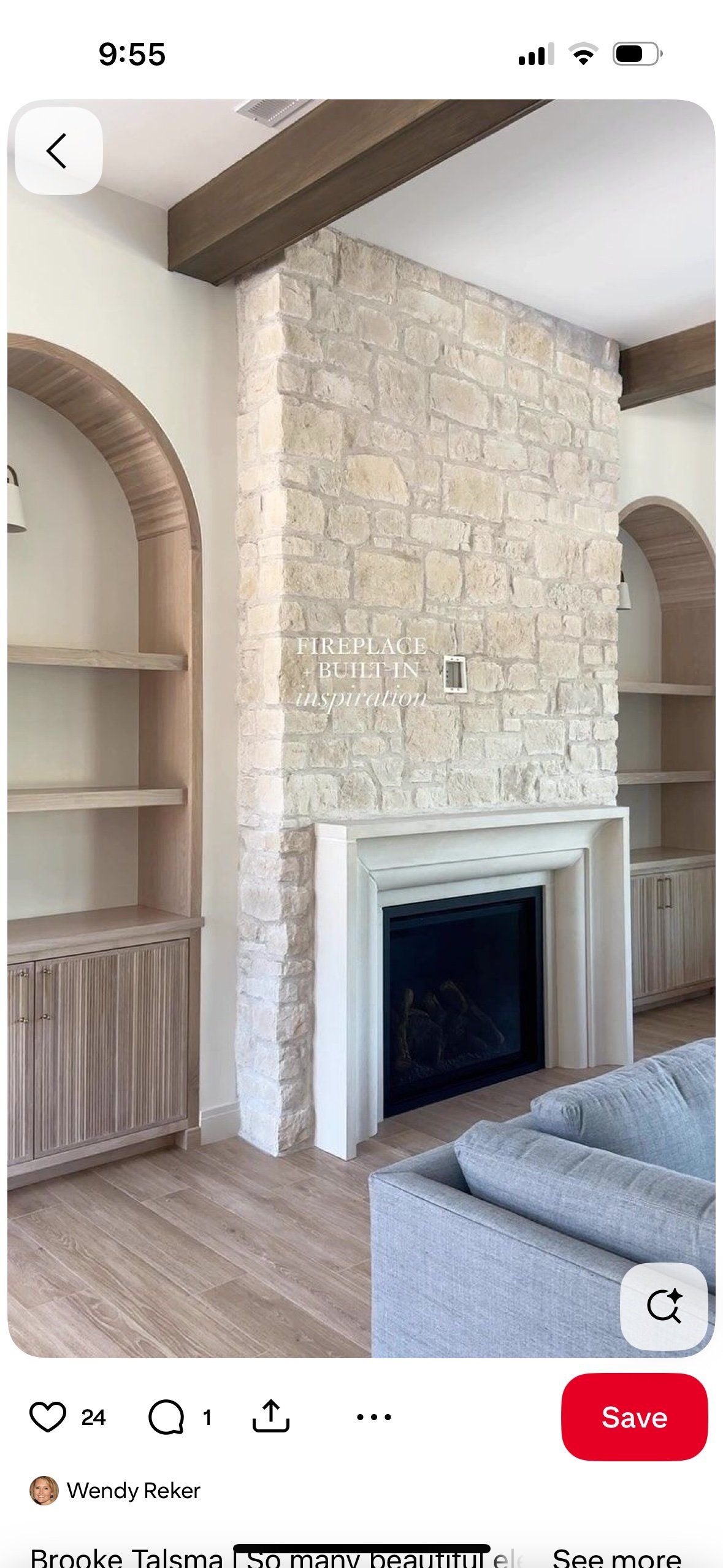

Stacy_Williams Posted October 22, 2025 Share Posted October 22, 2025 Can someone guide me on how to make a mantle like this photo? Thank you! Link to comment Share on other sites More sharing options...
robdyck Posted October 22, 2025 Share Posted October 22, 2025 (edited) The walls with stone are straight forward so I assume you can model those. Place a doorway for the fireplace opening and size it accordingly (you can use the doorway casing for a material to fill any space between the fireplace and the surround). place a fireplace, adjust size and position Place a Fireplace Surround from the Eldorado Stone Catalog (The Giada) Edited October 22, 2025 by robdyck Link to comment Share on other sites More sharing options...
Chrisb222 Posted October 22, 2025 Share Posted October 22, 2025 2 hours ago, Stacy_Williams said: Can someone guide me on how to make a mantle like this photo? While the Giada is close, if you want to match that exactly, a molding polyline would do the trick. This article discusses using molding polylines: https://www.chiefarchitect.com/support/article/KB-02882/using-molding-polylines.html You may need to stack multiple molding profiles to achieve the exact look. This article is specifically a guide to creating a fireplace mantel, and includes tips on stacking multiple molding profiles: https://www.chiefarchitect.com/support/article/KB-00503/creating-a-fireplace-mantel.html Link to comment Share on other sites More sharing options...
robdyck Posted October 22, 2025 Share Posted October 22, 2025 Search the library for "Imperial Rake Crown AZM-6937" Resize to about 6" wide and 12" high Link to comment Share on other sites More sharing options...
