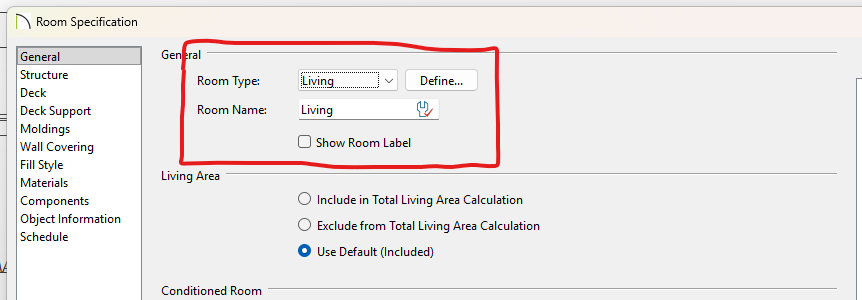

JonathanK Posted 21 hours ago Share Posted 21 hours ago I did some quick searching and haven't found what I'm looking for, but is there a way to have Room Type default to "Living" and have "Show Room Label" set as unchecked? See attached... Thanks. Link to comment Share on other sites More sharing options...
tundra_dweller Posted 20 hours ago Share Posted 20 hours ago Doesn't look like there is. It would be nice if there was a way to turn it off by default, or at least a "Don't show this message again" checkbox when it asks if you want to turn on your room label layer every single time you designate a room type on a new plan. Link to comment Share on other sites More sharing options...

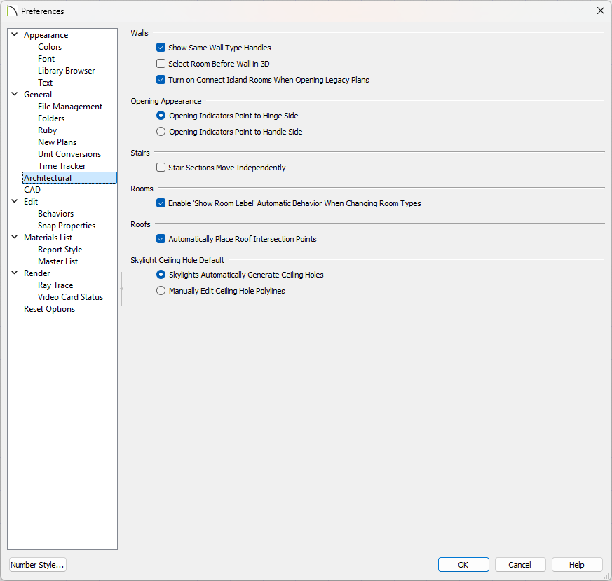

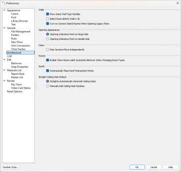

Solution DBCooper Posted 20 hours ago Solution Share Posted 20 hours ago You can turn off the automatic behavior in preferences. Look under "architectural" for "show room label". Link to comment Share on other sites More sharing options...
tundra_dweller Posted 20 hours ago Share Posted 20 hours ago 6 minutes ago, DBCooper said: You can turn off the automatic behavior in preferences. Look under "architectural" for "show room label". Beautiful, thank you!! Link to comment Share on other sites More sharing options...
