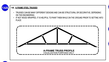

Cadwork22 Posted October 9, 2025 Share Posted October 9, 2025 I need to design a truss that looks like this. The settings for trusses are foreign to me. Thanks! Link to comment Share on other sites More sharing options...
Cadwork22 Posted October 9, 2025 Author Share Posted October 9, 2025 The span is about 30ft across Link to comment Share on other sites More sharing options...

Solution robdyck Posted October 9, 2025 Solution Share Posted October 9, 2025 Option 1: allow for the outer profile of the truss in your building design and leave the truss spec's up to the supplier. Indicate the roof space clearly in your section drawings. Option 2: Same as above, but include roof trusses in your section drawings. Manually edit the truss members to get as close as possible. Note that your trusses are illustrative and that supplier's spec's take precedence. In other words, do more work that's not necessarily accurate and at your own expense. 3 Link to comment Share on other sites More sharing options...
