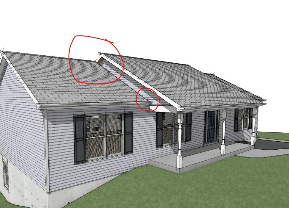

MtGipe Posted October 3, 2025 Share Posted October 3, 2025 (edited) I know I've done this before with auto-roof on...but the technique is eluding me today. Can someone remind me how to get the soffit on the upper gable walls to show and the lower gable roof plane to extend to the attic wall? Thanks! Edited October 3, 2025 by MtGipe typo Link to comment Share on other sites More sharing options...
Mark3D Posted October 3, 2025 Share Posted October 3, 2025 Can you upload the plan as it is hard to see what is going on Link to comment Share on other sites More sharing options...
mtldesigns Posted October 4, 2025 Share Posted October 4, 2025 7 hours ago, MtGipe said: get the soffit on the upper gable walls to show and the lower gable roof plane to extend to the attic wall Hey Marshal, do as you just stated. On the lower section, grab the roof plan, you'll see a grip. Pull that to your raised attic wall, it should snap right at it. That will automatically put your soffits in... Link to comment Share on other sites More sharing options...
