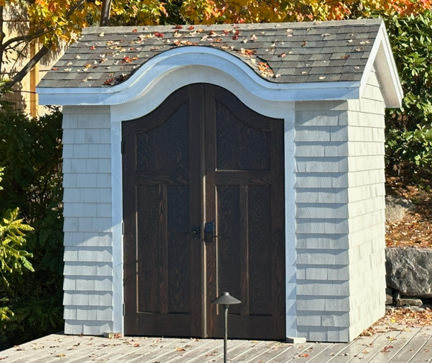

JDCH603 Posted October 3, 2025 Share Posted October 3, 2025 Anyway to draw an eyebrow roof line? I see you can do an eyebrow dormer but I can't seem to position it at the wall or make it small enough. Link to comment Share on other sites More sharing options...
robdyck Posted October 3, 2025 Share Posted October 3, 2025 Yes, you can use curved roof planes. In elevation view, first establish the geometry using CAD tools. You can also use construction lines to identify the transition points across multiple views. Take note of your CAD radius and use that information to create the roof planes. You only need to draw the roof planes on one side, then copy & reflect about the center line. Keep in mind that the length and radius are most important to begin with. In elevation view, you can adjust the height using the transform / replicate tool, or the point-to-point move tool. Link to comment Share on other sites More sharing options...
