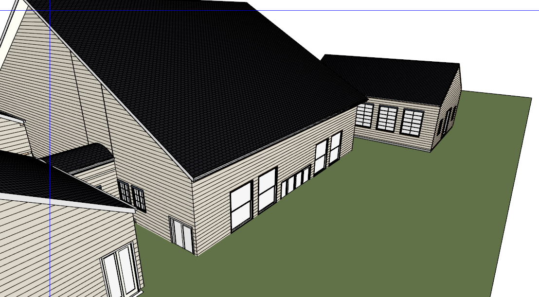

Cadwork22 Posted September 19, 2025 Share Posted September 19, 2025 You can see in the image the doors are covered halfway by the terrain. I'm new with terrain features, I need to know how-to create a dip in the terrain without effecting it elsewhere. Thanks in Advance 1 Link to comment Share on other sites More sharing options...
javatom Posted September 19, 2025 Share Posted September 19, 2025 Use the elevation region tool. Set the region to a negative number. 1 Link to comment Share on other sites More sharing options...
