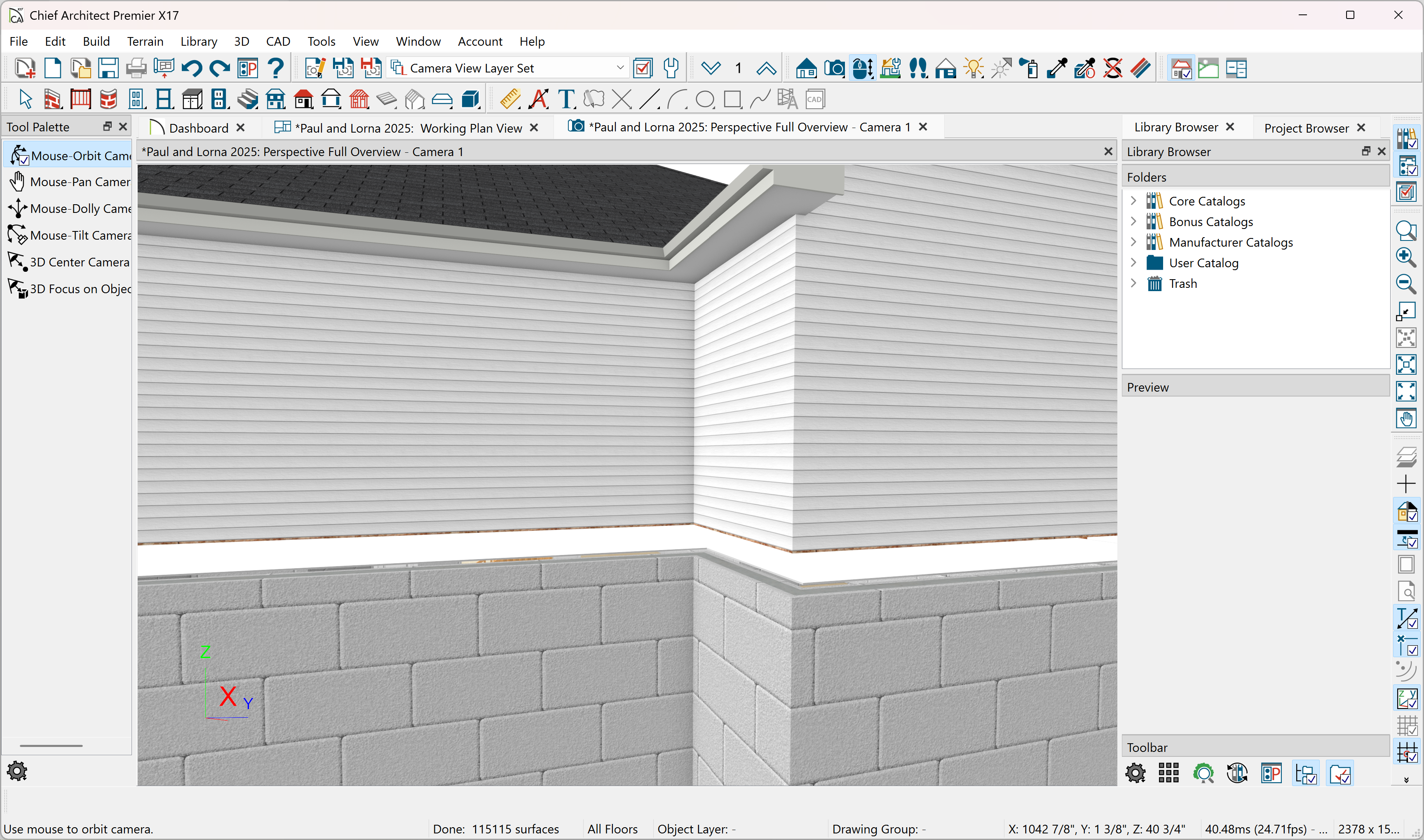

signahome Posted September 14, 2025 Share Posted September 14, 2025 the 3d and elevations are missing the rim joist how do i fix Link to comment Share on other sites More sharing options...
DBCooper Posted September 14, 2025 Share Posted September 14, 2025 I don't think you actually want to see the rim joist because the siding should be dropping down to cover it. So things I would look at would be to see if your walls are set the default heights (you should not need to manually change wall heights except for special situations) or if you have done anything goofy in your floor structure. An easy way to reset your wall heights is to use the "reset to defaults" tool. If this doesn't help, then you should probably post your plan. Link to comment Share on other sites More sharing options...

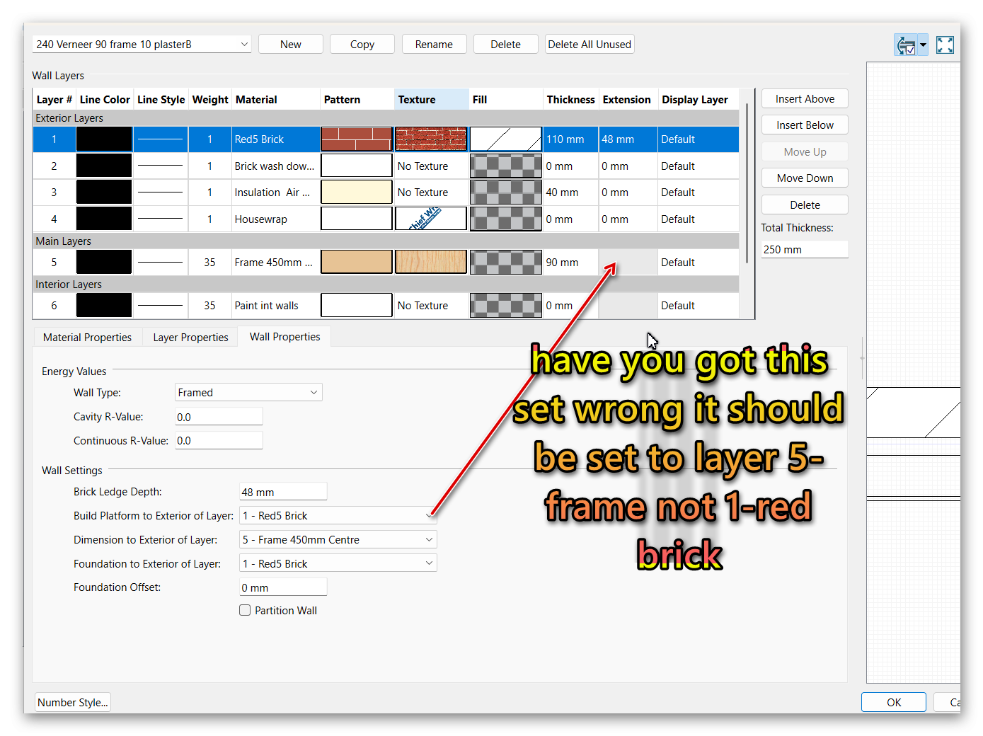

Mark3D Posted September 14, 2025 Share Posted September 14, 2025 Check this setting Link to comment Share on other sites More sharing options...
signahome Posted October 19, 2025 Author Share Posted October 19, 2025 Mark 3D that what i had wrong... thank you Link to comment Share on other sites More sharing options...
