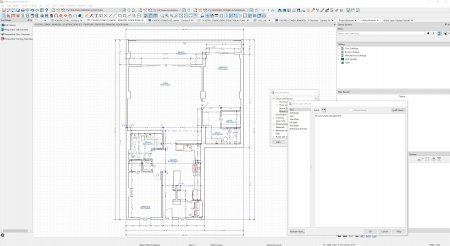

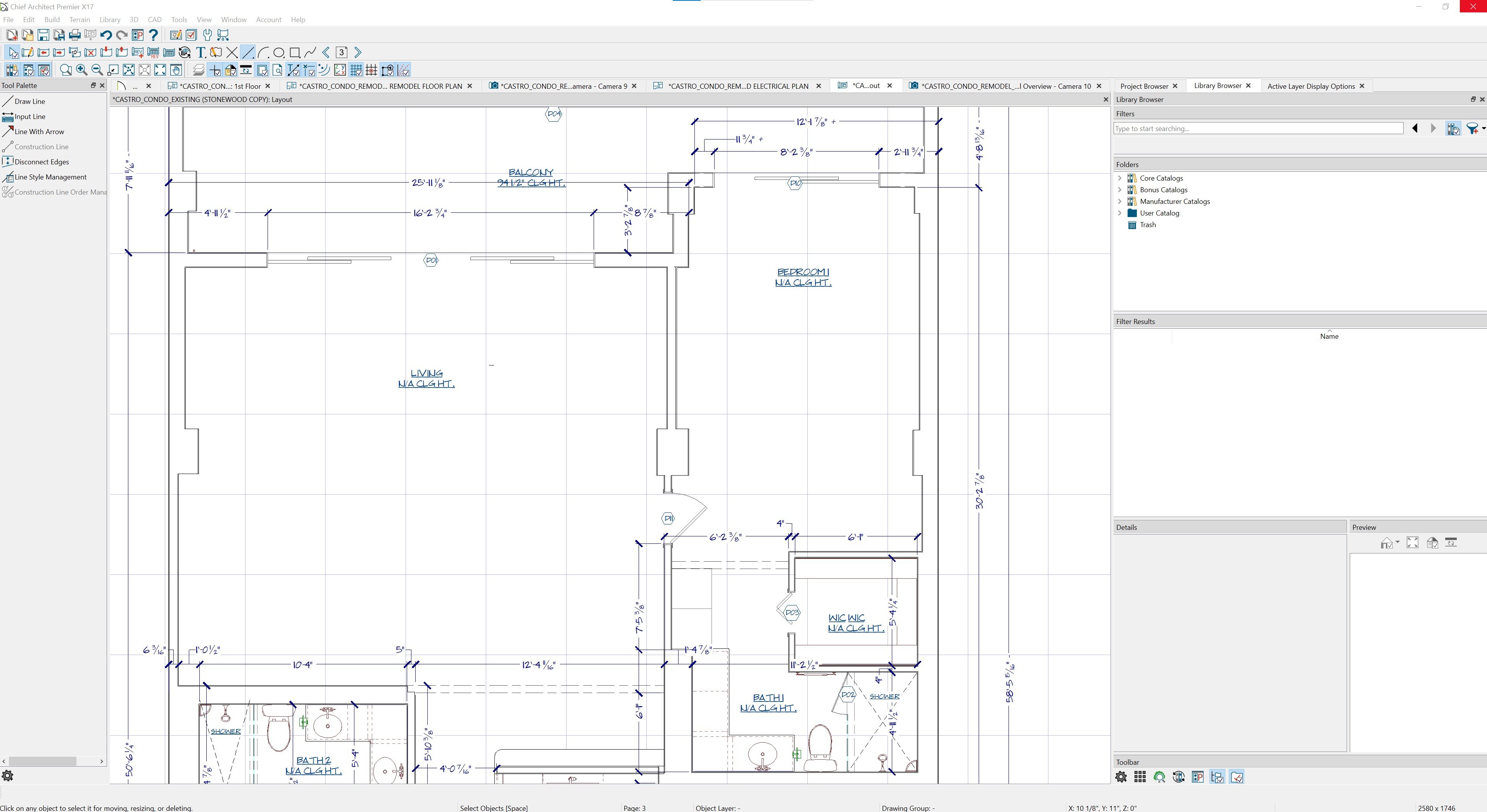

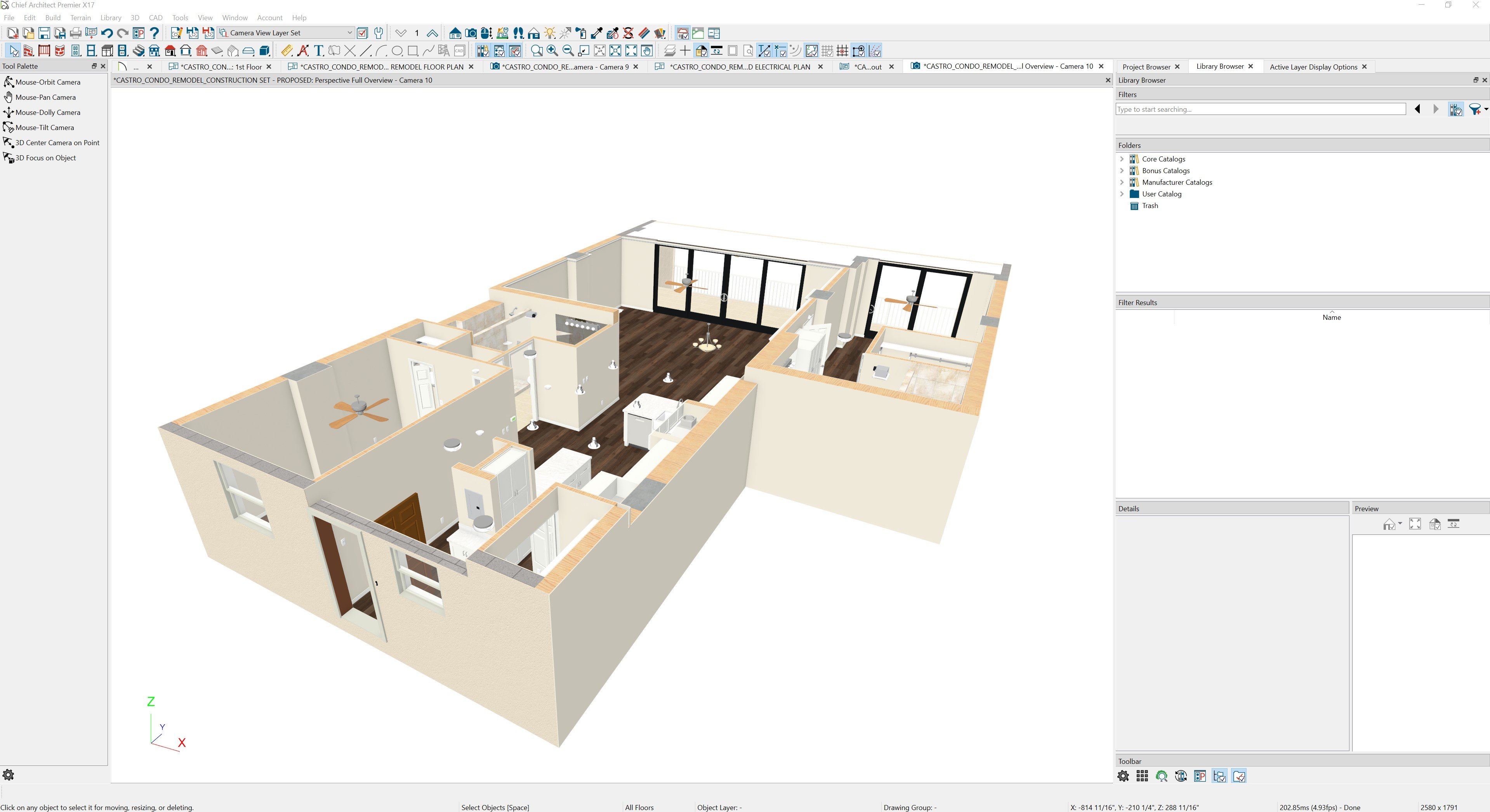

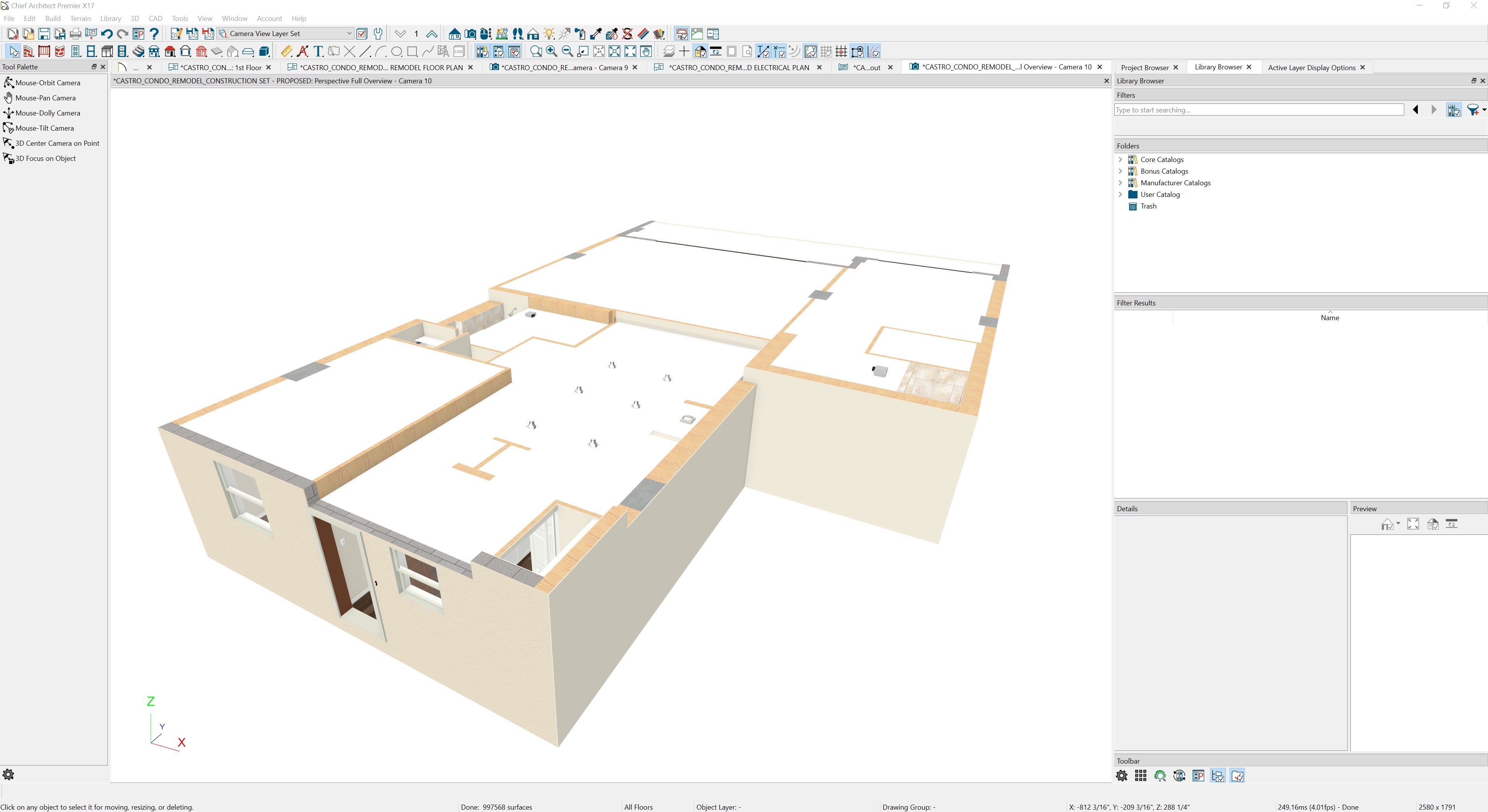

KKBKeith Posted September 2, 2025 Share Posted September 2, 2025 (edited) Hi all, I am sending my views to layout & have the room labels default setting to display finished ceiling height, but when sending a rendered overview to layout I must turn off the ceilings in each room to make everything visible. This makes my room ceiling height display as N/A. Is there a better way to work around this? Thanks. My room label settings Perspective full overview w/ ceilings turned on Perspective full overview w/ ceilings turned off Ceiling Ht now N/A Edited September 2, 2025 by KKBKeith added pic Link to comment Share on other sites More sharing options...

Solution KKBKeith Posted September 2, 2025 Author Solution Share Posted September 2, 2025 (edited) 56 minutes ago, DBCooper said: How are you turning off the ceilings? Have you tried turning off the layer for ceilings instead of removing the ceiling using the room dialog? In the general display properties & the room object display properties the layer set I'm working with has ceiling break lines, planes & surfaces all turned off. The only way I have been able to turn off ceilings in rendered views is with the turn ceiling on/off commands when selecting each individual room. Is there another way? OOPS. I didn't realize the layer set in the rendered view could be toggled & set on or off. Thanks, I got it now. Edited September 2, 2025 by KKBKeith Link to comment Share on other sites More sharing options...
Chrisb222 Posted September 2, 2025 Share Posted September 2, 2025 2 hours ago, KKBKeith said: Perspective full overview w/ ceilings turned off Why not use the Perspective Floor Overview camera? The ceilings are turned off automatically, without you changing the model. Link to comment Share on other sites More sharing options...
