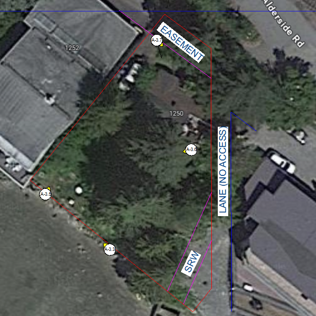

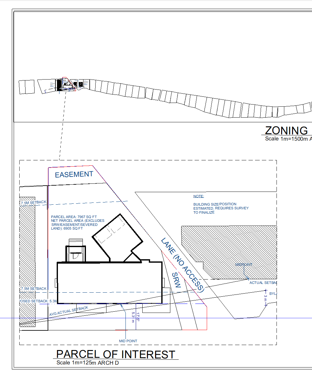

SHCanada2 Posted August 29, 2025 Share Posted August 29, 2025 (edited) 9 hours ago, Evolution said: I have reset the default cad line to show bearing in degrees and minutes, and the line length in decimal feet however I have not been able so far, to reset the drawing scale from it's current default to the scale I need which is 1"=200'. 1"=50' for this plot would likely work as well. I'm not sure I understand. If you draw it on your plan view, you can send it to layout at whatever scale you would like. I do something similar to this: Trace a Terrain Lot Image to Create a Site Plan or Terrain Perimeter - Video | Chief Architect and then I put different things on 2 different layers if I have two different scales in layout. One layout box(typically 1:500 or 1:1000) is set to one layerset, and the other layout box (typically 1:100) is set to the other layerset. The result on layout is: Edited August 29, 2025 by SHCanada2 Link to comment Share on other sites More sharing options...

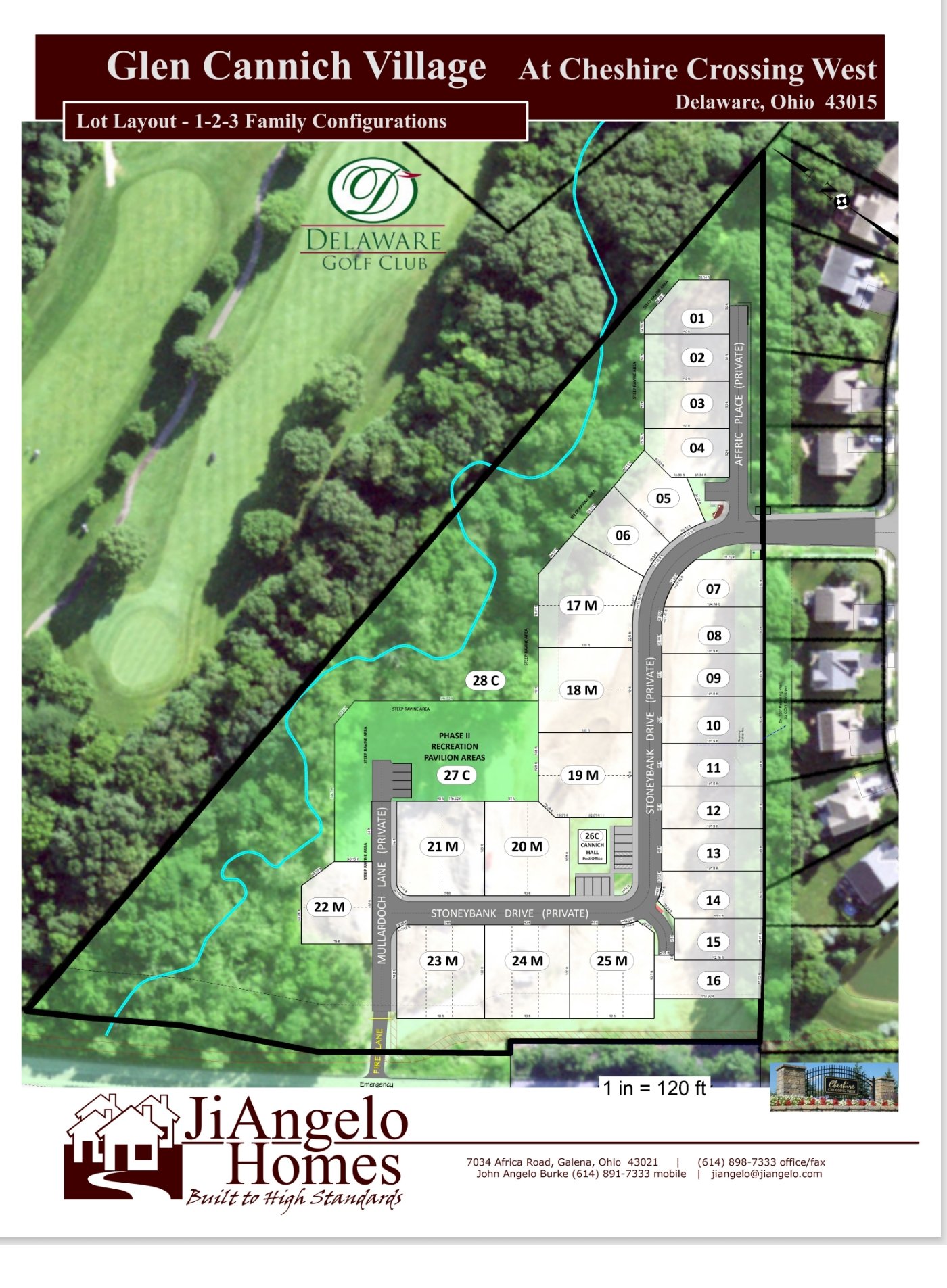

JiAngelo Posted August 29, 2025 Share Posted August 29, 2025 The county GIS maps, if you are downloading them in dxf format contain the bearing and distance informations in the lines themselves. Turn on distance and angles for each line and set cad to decimal feet and quadrant bearings. Like @SHCanada2 said in Chief you draw real world dimensions. The send to layout whatever scale you desire. Here's a 34 lot subdivision I drew in Chief. The engineer and I traded dxf files back and forth during the course of construction. So now Chief includes all the sewer, water, gas lines. I was even able to get dxfs from the electrical company for all their transformers and conductor line routes. Link to comment Share on other sites More sharing options...
SHCanada2 Posted August 29, 2025 Share Posted August 29, 2025 (edited) 21 minutes ago, JiAngelo said: Here's a 34 lot subdivision I drew in Chie I like how you did the shading to still show through some of the satellite image for the parcels. Normally I just show the lot outline...which is not as pretty and less readable than yours: learn something new every day.. Edited August 29, 2025 by SHCanada2 Link to comment Share on other sites More sharing options...
