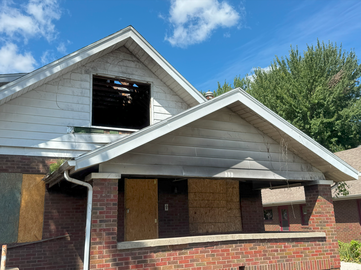

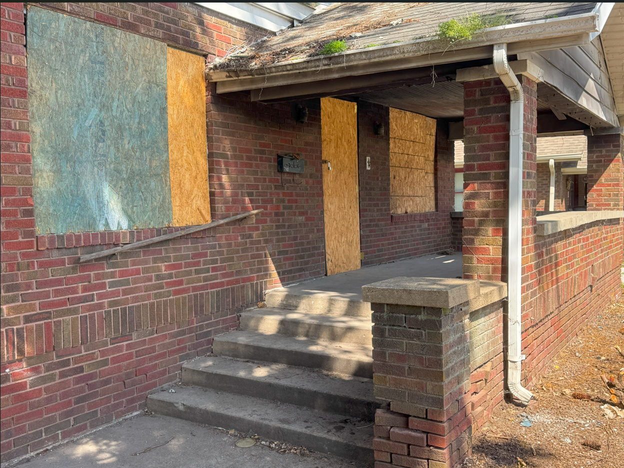

dcook627 Posted August 27 Share Posted August 27 (edited) I have gone back and forth with how to do this and I have not yet figured out how to make it work. Has anyone done this type of porch before who can give me some guidance? I'm on X17, if that matters. Thank you all in advance for any advice you can offer! David Cook Edited August 27 by dcook627 To remove photo links and replace with inline photos. Link to comment Share on other sites More sharing options...

Solution robdyck Posted August 27 Solution Share Posted August 27 (edited) A pony wall and wall cap would work for the central stub wall portion. For the post and cap, a couple of 3d solids are the fastest, although I'd convert the 2 objects to a symbol with stretch planes so that it can be used for any height and width of column. It's pretty easy to figure out the width and depth by counting bricks. Edited August 27 by robdyck Link to comment Share on other sites More sharing options...
robdyck Posted August 27 Share Posted August 27 The loose bricks are a bit more difficult to model as Chief doesn't have an earthquake feature! For those, you'd need to place them manually. Link to comment Share on other sites More sharing options...
