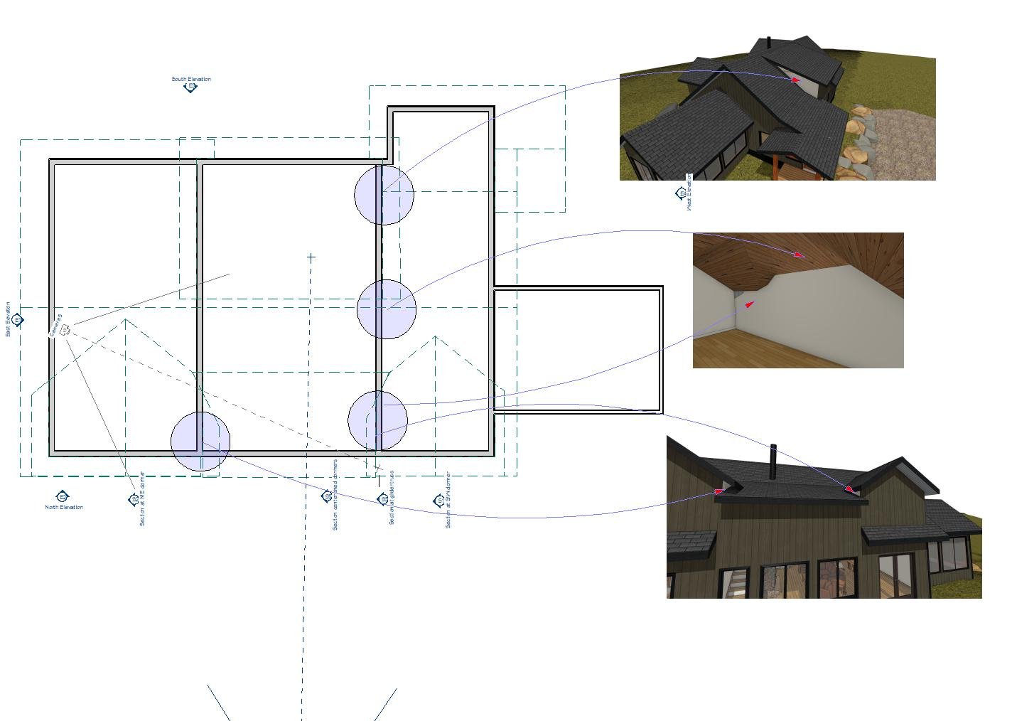

MN_JohnH Posted August 15, 2025 Share Posted August 15, 2025 I have a wall here I can not figure out. It is mostly an interior wall that has portions that are on the exterior to be a different type than below the roof. But the side that the siding need to be on is opposite on each end. But I don't think that is the problem necessarily, for some reason it builds as an interior 6 above roof even though it is set as a siding wall to have interior 6 below.. Why doesn't it build up into the high gable? I mirror copied it from the other similar wall and that other wall seems to be working fine. Why is the exterior portion above the roof still Sheetrock? What is going on in that inside interior corner where there is some siding showing? The interesting thing is, I rebuilt it and it all looked great till I closed it and reopened it again, then this problem still persists. The only difference between the two walls that I can see is this wall that I am having the extra trouble with does not carry down to the main floor. That is intentional, that is going to be open on the main level, this wall is just on the second level. I have a picture here that sort of shows the issues. It's a large file so I have it in a drop box here: https://www.dropbox.com/scl/fi/gsypb3i6xyxmsv482lell/Complete-rebuild-8-15-25.plan?rlkey=vunr5v60zq4ybo9o3xmnx9rsy&st=pamirn5y&dl=0 Link to comment Share on other sites More sharing options...

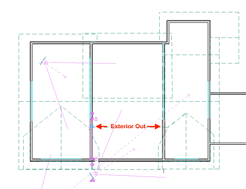

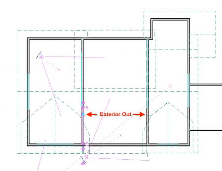

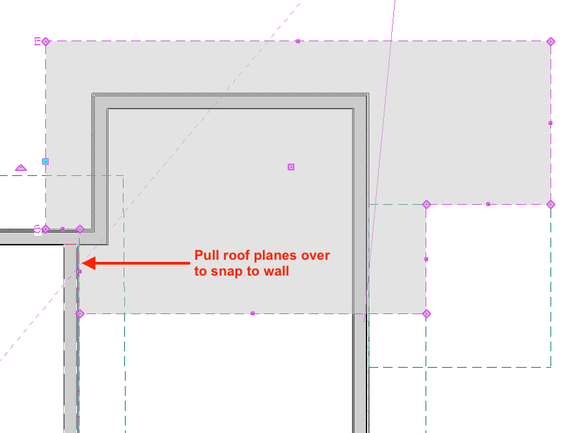

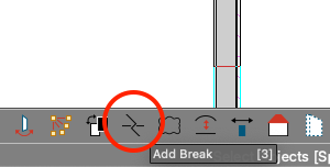

Chrisb222 Posted August 16, 2025 Share Posted August 16, 2025 19 hours ago, MN_JohnH said: But the side that the siding need to be on is opposite on each end. You have to split the wall using the Add Break tool, and reverse the interior/exterior direction: 19 hours ago, MN_JohnH said: Why doesn't it build up into the high gable? I simply went to the Attic layer and added an attic wall. 19 hours ago, MN_JohnH said: Why is the exterior portion above the roof still Sheetrock? Pull the roof planes over to snap to the wall: You've got some other issues to do with spraying the wall material (not advised), among other stuff, but that's as far as I took it. Get that stuff fixed then let us know if you still have other problems. Link to comment Share on other sites More sharing options...
