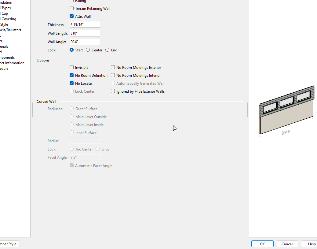

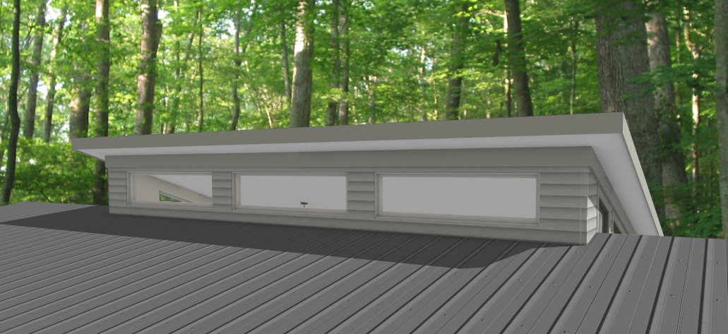

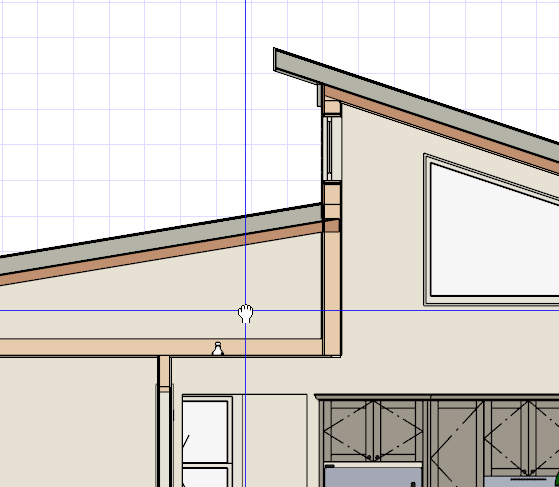

GeneDavis Posted August 5, 2025 Share Posted August 5, 2025 Three pics attached. Exterior view, wall opened for spec (note it is checked as attic), section. I am unable to specify different casing, sill, and apron trim for exterior and exterior. Link to comment Share on other sites More sharing options...
DBCooper Posted August 5, 2025 Share Posted August 5, 2025 Chief probably thinks the window is on an interior wall. Try checking the option for "separate trim and materials on each side". Link to comment Share on other sites More sharing options...
GeneDavis Posted August 5, 2025 Author Share Posted August 5, 2025 Thanks! That's it. Wonder why it is considered an interior wall. I could not find any Chief traning vids about clerestory windows and walls. Link to comment Share on other sites More sharing options...
