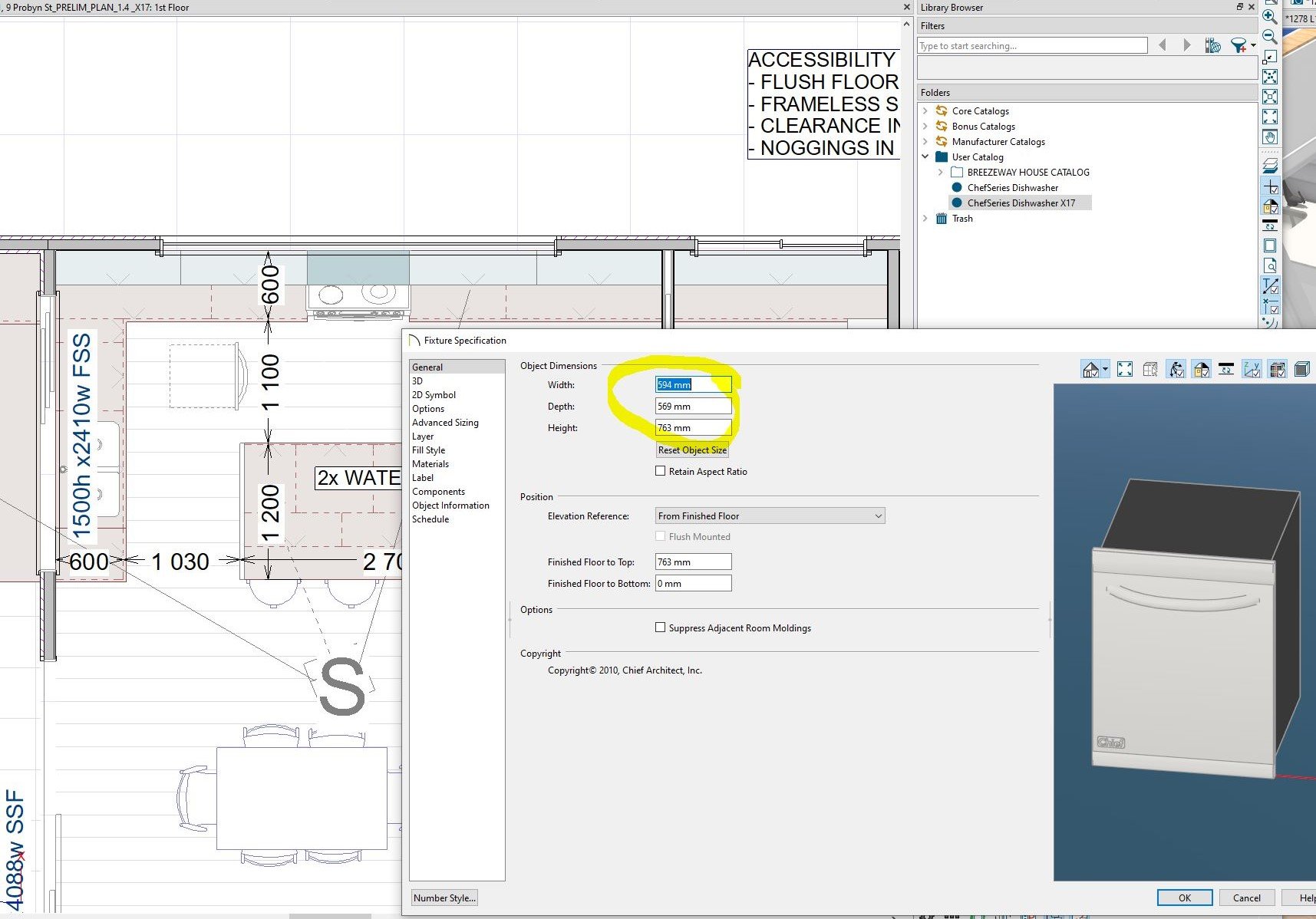

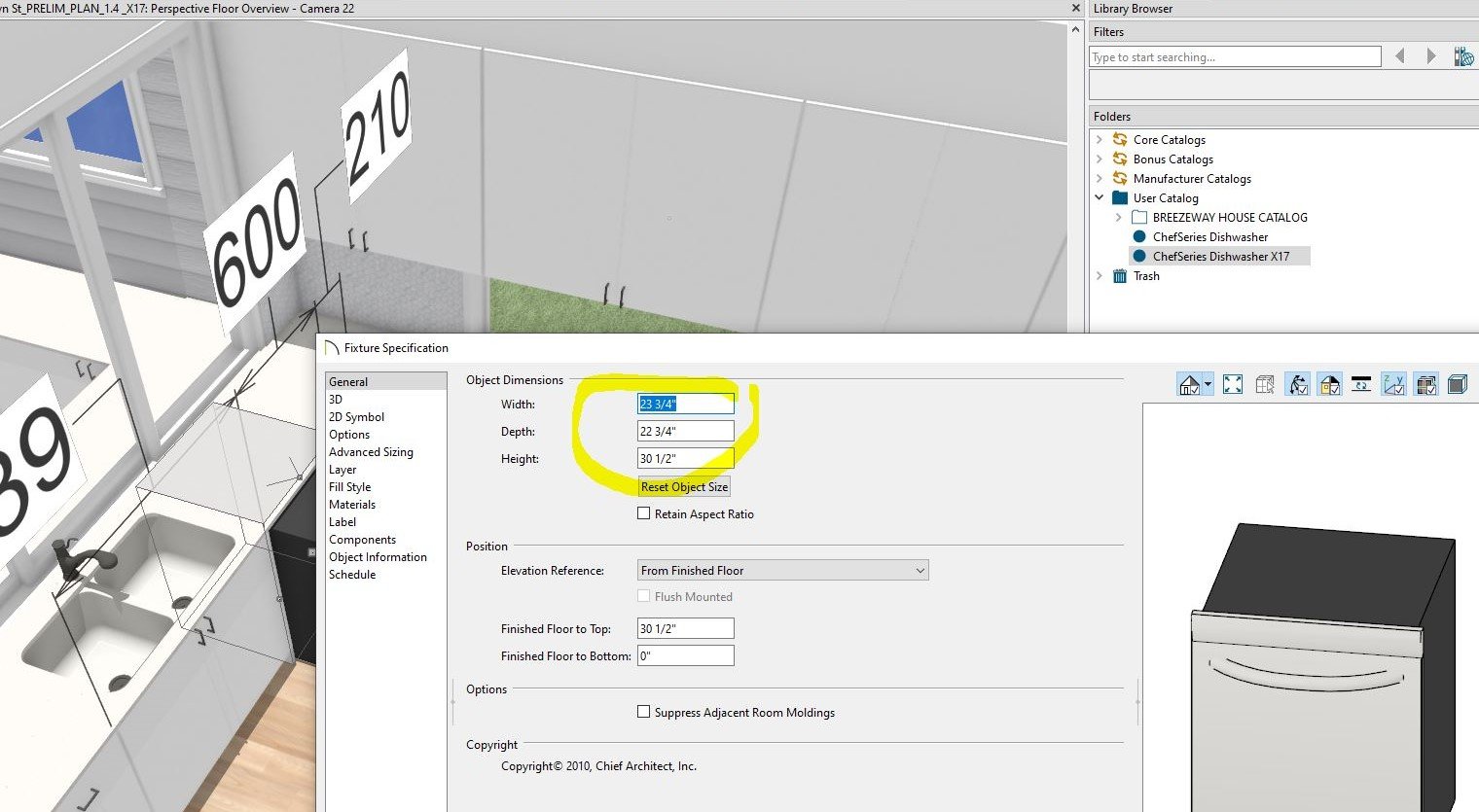

Breezeway01 Posted July 23, 2025 Share Posted July 23, 2025 I've just started using X17 and noticed an annoying bug (we'll I'm pretty sure it's a bug and not a setting). When editing an object in my library in PLAN VIEW, all sizes are metric as it should be. Same with Elevations. However, when I do the exact same thing but in a 3D CAMERA VIEW, suddenly all the sizes are imperial???!!! See attached screenshots. Link to comment Share on other sites More sharing options...
DBCooper Posted July 24, 2025 Share Posted July 24, 2025 I think your right that this might be a bug but it doesn't do that for me. I just tried with a metric plan and while the plan is the active view, whether it is a plan view or camera view, when I edit an appliance in my library it shows me metric units. I'm not working in project management mode so I don't know if that makes a difference. Regardless, you might want to report it to Chief and see if they can figure out what is wrong. Link to comment Share on other sites More sharing options...
Breezeway01 Posted July 24, 2025 Author Share Posted July 24, 2025 Thanks. I hope it's not just my computer! Yes I'm not on Project management mode either but not sure that would make a difference anyway. Link to comment Share on other sites More sharing options...
MPDesign Posted July 24, 2025 Share Posted July 24, 2025 I just tested my metric plan template, all working as expected. All views showing metric sizes. Were you using beta before the full release? I would suggest try a repair install, then tech support if that doesn't work. Link to comment Share on other sites More sharing options...
Breezeway01 Posted July 27, 2025 Author Share Posted July 27, 2025 No, never used the beta version. Thanks for testing. Link to comment Share on other sites More sharing options...
