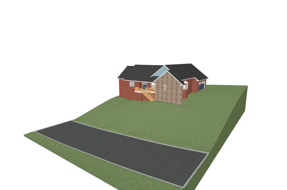

Tryingtobezen Posted July 17, 2025 Share Posted July 17, 2025 Maybe I'm just exhausted but this one is kicking my bootie. If anyone could explain what I'm doing wrong I would appreciate it so much! I have used the terrain line tool and tried to graduate the slope but its making the front yard super high. Also, my roof keeps showing odd angles even when I've prompted them to be full gables.. I have added the hover info and the zip file of the plan. Any help would be greatly appreciated! Thanks! Fox Zip.zip fox - measurements hover.pdf Link to comment Share on other sites More sharing options...
CharlesVolz Posted July 17, 2025 Share Posted July 17, 2025 Terrain Basics: Do not let your elevation data overlap each other. Make sure elevation lines and regions do not cross or intersect themselves or other terrain data (or even too close to each other). Use elevation lines and regions (not elevation points). Make elevation lines and elevation regions extend to outside of the terrain perimeter. Make elevation lines continuous without breaks. Keep elevation data (elevation lines, splines, regions, etc.) simple, without sudden bends. 2 Link to comment Share on other sites More sharing options...
Mark3D Posted July 18, 2025 Share Posted July 18, 2025 I had play with your model its rough but the basic shape is there you will need to get it more accurate, hopefully you can continue from that, as for the terrain i got rid of over lapping height data see if you can follow on from there to get it better. I made your terrian data standout it helps when trouble shooting terrain problems you should be able to see any overlapping height data issues. Fox.zip Link to comment Share on other sites More sharing options...
