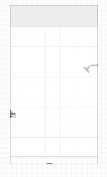

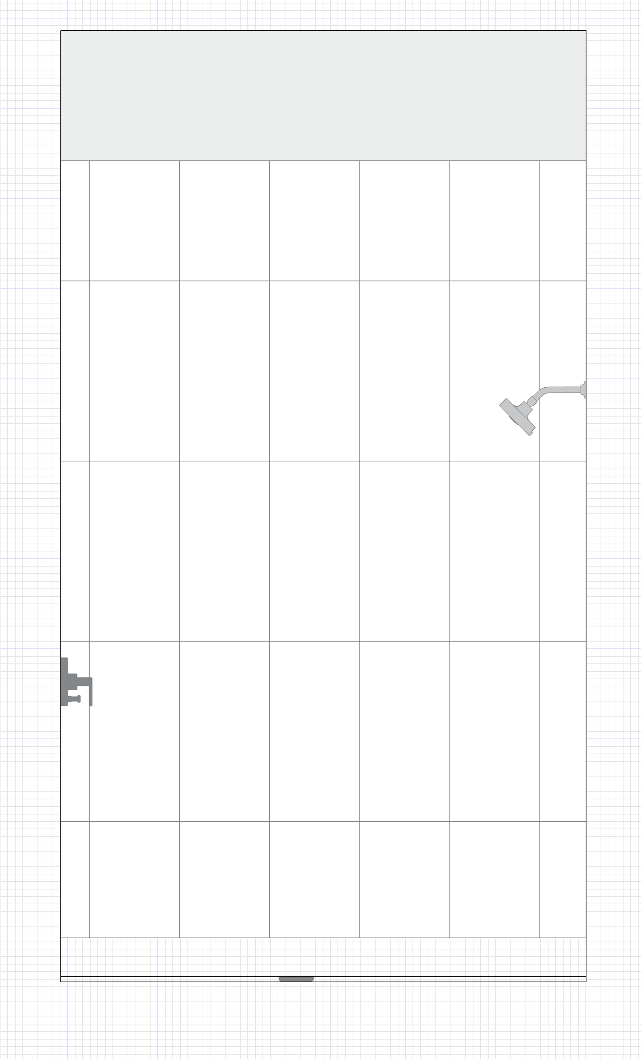

JBi-PDX Posted July 16, 2025 Share Posted July 16, 2025 Here in Florida, we do a lot of drop down showers (6" below the dry floor). When I add the material region to the shower walls, the material doesn't go all the way to the floor of the shower (you can see the drain at the bottom of the shower). The material region goes to the floor on another wall, but not this one. I have the elevation camera set to back clip just behind the tile layer. Any thoughts? Link to comment Share on other sites More sharing options...

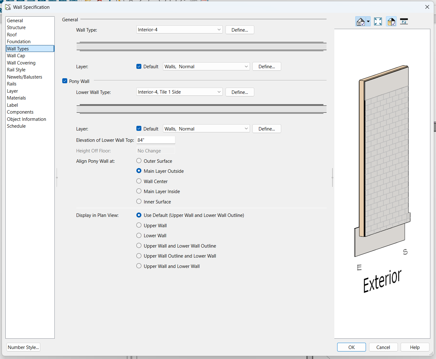

JonathanK Posted July 16, 2025 Share Posted July 16, 2025 Why use a material region, and not use a wall type that has tile on one side? You can set it as a pony wall with a standard interior wall on the top and adjust the height as needed in the wall dialog box. Link to comment Share on other sites More sharing options...

JonathanK Posted July 16, 2025 Share Posted July 16, 2025 31 minutes ago, JBi-PDX said: That seems complicated.... Not any more or less complicated than pulling an elevation view, and drawing a material region, etc... The nice thing with this, is that you have the wall type forever. No need to recreate it. And it can be as detailed as the architect wishes. Personally, I keep material wall regions to things like tile backsplashes, or odd/ends type regions. Link to comment Share on other sites More sharing options...

JBi-PDX Posted July 16, 2025 Author Share Posted July 16, 2025 I figured it out - you have to select "Default Wall Bottom Height" on the wall specification of the wall behind the material region. That carries the wall all the way down to the new lower floor height. Thanks, everyone. Jason Link to comment Share on other sites More sharing options...
