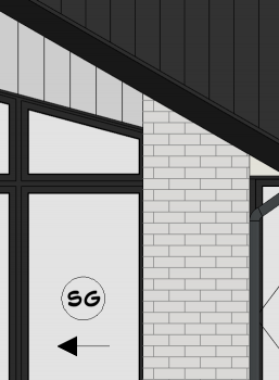

So I have an issue when I want to have a cladding junction generally with brick and a thin cladding for display in the elevations and 3-D
The air / wet / drained brick cavity is 50mm and then if the makeup of the other cladding is thinner than 50mm then the layer in the wall (the brick)  auto laps over the cladding at the junction which is an issue when I butt the window at the junction as the brick covers over the window, is there a way to control this??
I know I can 'Fake it' by adding more thickness to the thinner cladding but I like it to be real.
Attached is how it looks on the floor plan (works)
How it looks in the elevation (fails) and then a real world exsample to help explain the setup
Thanks in advance

For finer control, I would break the walls as you have done but keep the layers thickness the same for each wall (if you need the wall lengths to report to a schedule by name). Then add the brick on the "brick" wall with a wall material region. Breaking walls at a window or door is always going to create issues in Chief if you want fine control.

I would recommend using a polyline solid for this instance. I tested your example and came up with the same result. It seams that the wall auto wraps the end with the exterior layer material in elevations.

The only realistic solution I have come across is the one you have already mentioned:
Add a vented cavity batten behind the cladding to bring the outside of the cladding out beyond the start of the brick (51mm from stud).
It also works if you make the brick layer a main layer, but that does introduce a host of unintended consequences.
